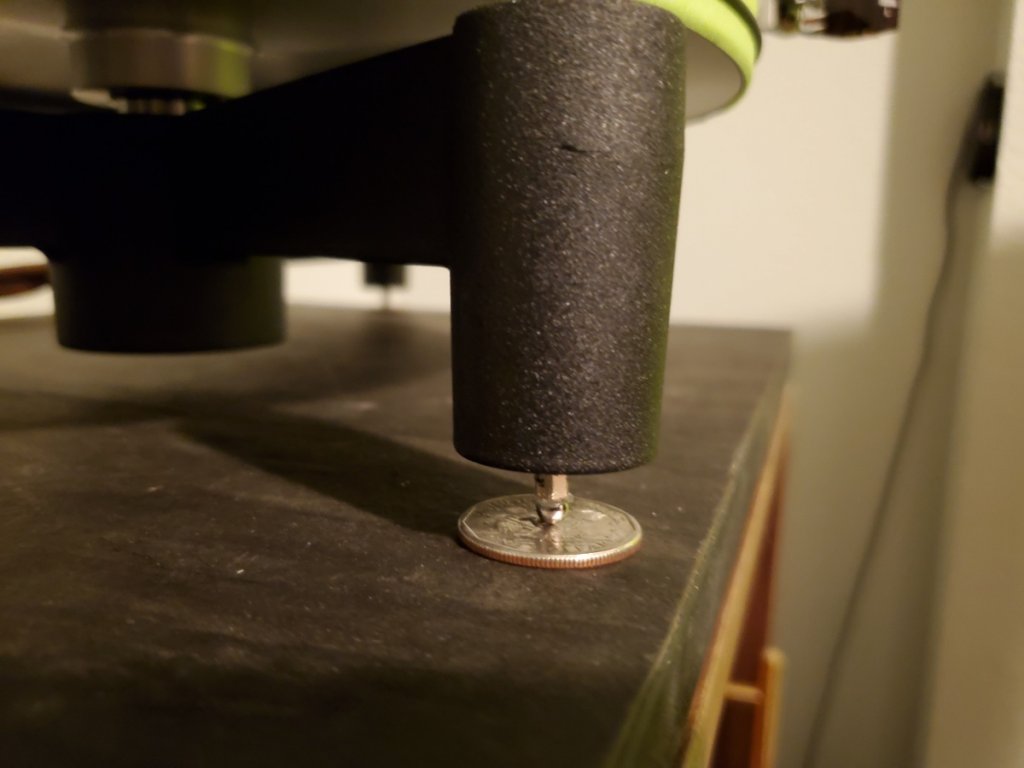

My Schiit Sol had no leveling feet but it did have little sorbothane bumpers that screwed into the bottom of it. I saw a post where someone made leveling feet using computer motherboard standoff screws, glued on ball bearings and placed them on a dime with a tiny hole inside for securing it. I copied that and made them a better audiophile version by using silver dollars which must sound better because it was more expensive. I didn't need the original little sorbothane bumpers because the entire table sits on a block that has sound deadening pads and supported by sorbothane orbs.

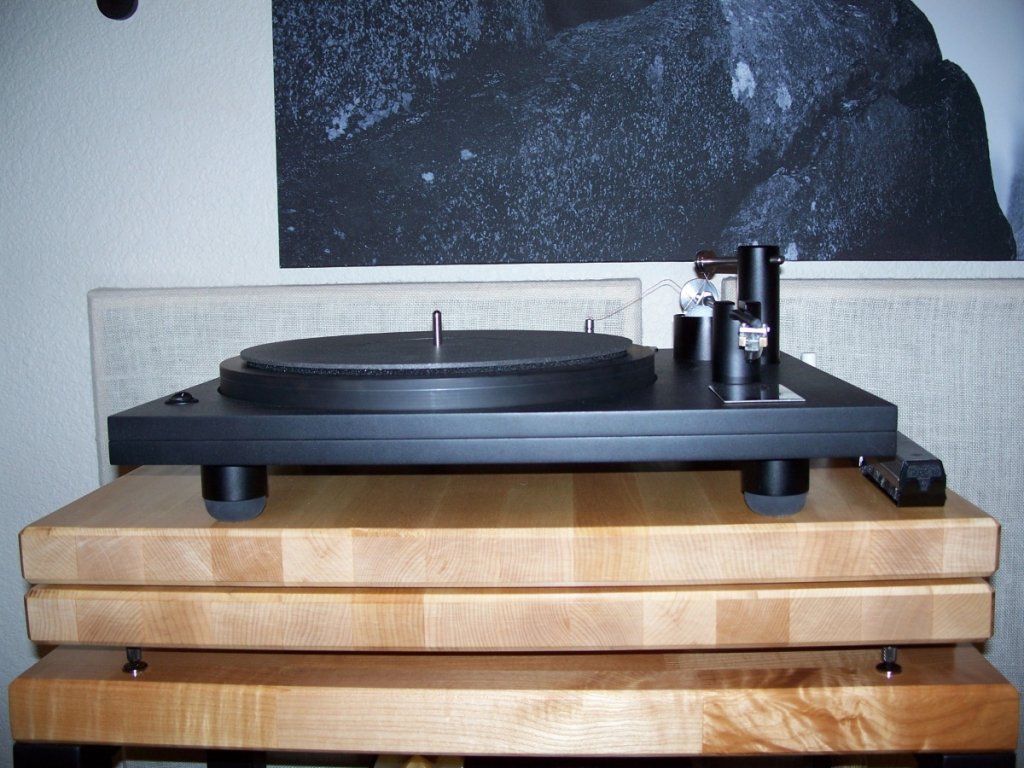

I level the stand, then level the butcher block, then the TT on the butcher block.
Both current TT have three feet (by chance) and it does make it easier to level them.
I use exotic woodblocks, and the easiest way is to swap the slightly uneven blocks around
I have also used Post it notes. Mainly because they are equal size thin shims.
I use a flat quality level trying all over the TT.  It is nice if the spindle can be removed. One TT yes other nope.
One TT has dual side bearings, the other unipivot
