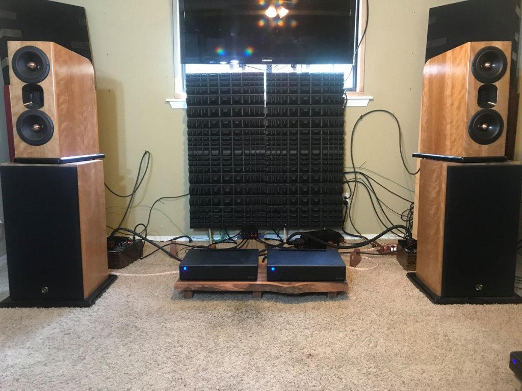

TV on wall works fine. I used a down and out style mount designed for TVs that are mounted over a fireplace and mounted the TV high enough up that when pushed back against the wall the top of the TV almost touches the ceiling. This lets me position the TV at a normal height when watching movies (though it is still well behind the speakers) yet get it up and mostly out f the way when listening to music.

Mine is a 55" LCD flatscreen on studs. In my case there was a window where I wanted to mount the TV so I built a 2x4 stud frame inside the window opening and attached the mount to the frame.

@mlundy57 - those are some beautiful speakers - I love how you have integrated the design between the various components.
