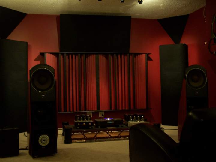

Has anyone tried deflecting, rather than diffusing, the rear wave by using a board angled in such a manner that the speakers are not visible through a mirror placed on the front walk? Robert E Greene suggested that, instead of absorbers, on sidewalls in order to creat a RFZ of sorts.
Al
Something like this ?
This room was supposedly designed by Rives Audio.

Re: Diffusion behind x series
« Reply #5 on: 30 May 2021, 03:47 am »
« Last Edit: 30 May 2021, 04:06 pm by emailtim »

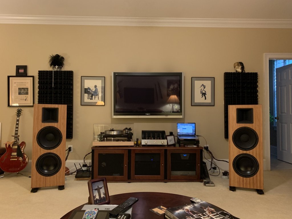

I use PI Audio Mr T Diffusers behind my X2's with great results. These diffusers are designed for Open Baffle specifically. GR research also used them. https://piaudiogroup.com/
Go to the bottom of the webpage and look for ABB1 Mr. 'T' Hemispherical Radiation

emailtim
« Reply #9 on: 30 May 2021, 04:08 pm »
Thanks but I can't open it. Oh well.
Al
I posted it to imgur as well.  Don't know why it is not showing up.
https://i.imgur.com/YaPquyk.jpeg

« Reply #10 on: 30 May 2021, 04:12 pm »
Thanks, that worked. Looks great and gives me some good ideas!
I have the same behind my X5’s. Love supporting Dave at PI Audio.  He’s a class act and always helpful, honest, and high integrity.

Hi, Al, I also purchased the ABB1 Mr. T diffusers but from Greg Rael. Made an immediate difference, one behind each speaker and two behind listening position.

I use two RPG BADArc diffusors in front of the TV. Works great and very easy to move out of the way.

GIK 4" Impression panels in front, GIK 242 Art panels at each FRP, and 3 GIK 4" 2'x5' free standing panels behind the listening position in front of a 12' glass sliding door.
