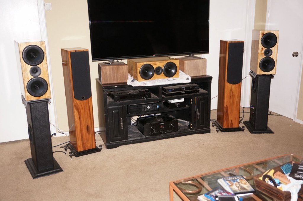

A pair of X-CS Encores with a sub (they definitely need a sub) is another excellent choice. Here's a pic of a pair shown with a matching center
