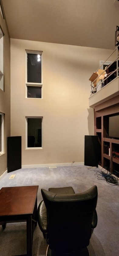

Well, I have taken the plunge and the 8C's will be arriving next week!
My 8c's have the black baffle with the natural body and will ultimately be on upgraded Sound Anchor stands (when they are available).
I also purchased the BAACH plugin. https://dutchdutch.com/products/bacch-plugin?pr_prod_strat=use_description&pr_rec_id=ceef46b22&pr_rec_pid=8667977515345&pr_ref_pid=8624328016209&pr_seq=uniform
The 8C's will be going into a room that is (w)13'x(l)19'x(h)30' with lots of windows.
I will start a new thread once the arrive.
George
On the Pallet:
From behind the listening chair:
Lots of windows:
« Last Edit: 1 Dec 2023, 11:04 pm by zybar »
