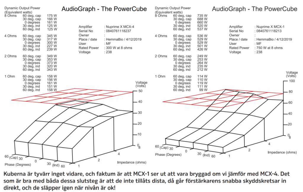

Hi All
Has anybody seen any power amp measurement on the MCX range, please link in that case.

I would like to see some third party power and distortion tests.

For stereo or mono amp, we use 1% THD as the max power through Audio Precision measurement.  This is the industry practice for high-end audio. But beware that many vendors use 10% THD for max power even if it is stereo.
For multichannel amp, the common practice is to use 10% THD as max power.  Furthermore, in multi-channel amp, the max power is typically not spec at all channel driven since that's not an impossible use case.  Some manufacturers measure 1 channel of the multi-channels (the other channels still consume power even though not driven), some give other channels 1/4 power.  I think Nuprime uses 2 channel max with 2 channels partial as the realistic MCX-4 spec.

sound and vision has some interesting measurements, not for the MCX, sorry.
With six channels driven into 8-ohm loads, the amp reaches 0.1% distortion at 105.7 watts and 1% distortion at 136.9 watts.

« Reply #7 on: 17 Jul 2021, 11:50 am »
6 channel fully driven is a condition that will never happen for music or movie.
