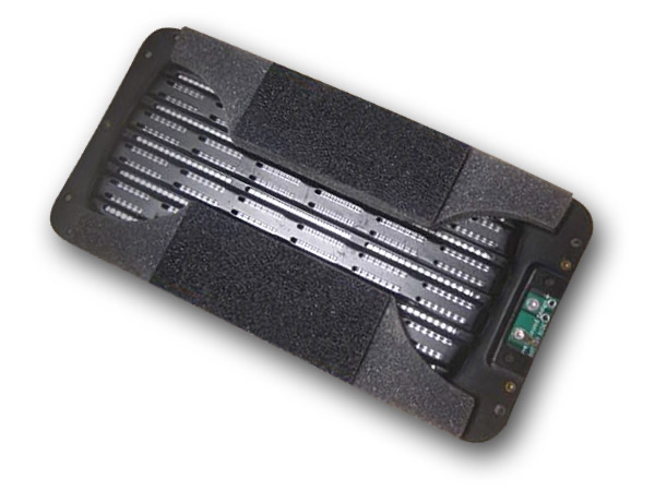

1. Wave guides - I have the wave guides with the long narrow slots - They look way cool - I took the speakers to a friend that builds speakers and he measured them and told me that the wave guides were a disaster - I like them a lot better with the wave guides than without - if I dropped them I think I would have to redo the crossover. Any thoughts? Do folks with RM-30 like the wave guides? Anyone have them without?

Speaking only to the wave guides:  Brian's second attempt (smaller flare-shaped guides for each speaker) worked a lot better than the long narrow ones.  John Casler can probably give you instructions for how to make them if you like what the wave guides do (I did, many don't)
Here are the sketches I made from measurements of the CDWGs that came on my RM30 Series II. I drew them so that my son could fabricate a set to replace his "speaker grill" type wave guides that came with his RM30s. They are mounted with the foam side facing the driver. My son was very pleased with the results.

Are there pictures of CDWGs ?  - I couldn't find anything on line
What is the material other than foam, and
How do you make them?
Maybe 3d printing?

Duck Duck Go vmps loudspeaker cdwg and look for the images with the long slits in the center of the speaker and the round holes. That is the CDWG mounted like a grill.

Here is a link:
http://pointillistic.com/vmps-audio/news.htm
Bulk Fine Foam Filter 60 PPI 12x16x3/8in Uni BF-4.   This is the foam I’ve used, but I see it out of stock. I’ve used the black abs plastic, which is textured on one side. Good luck

Found One

@Zakski288  We found it at the same time - I found some foam not sure about the 1/8th acryllic - then I would assume use a standard stretched fabric for the grill  -- Hate to loose that cool slotted cover - it just diodn't sound right with them off -- too forward or something  -- maybe this will be the answer

I have the materials for the CDWG but I haven't done it yet - I am thinking I can fit them under my slotted front covers - since the covers look cool and I can remove them for listening  - Thank you Doug Ravizza for the drawings
