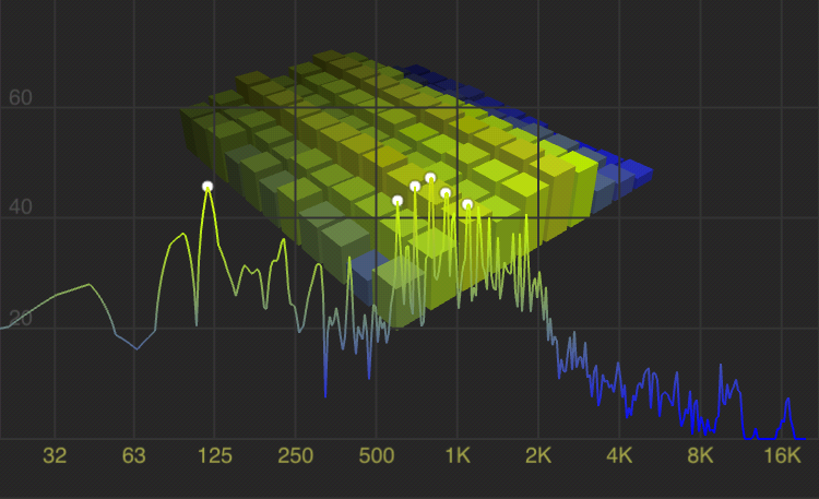

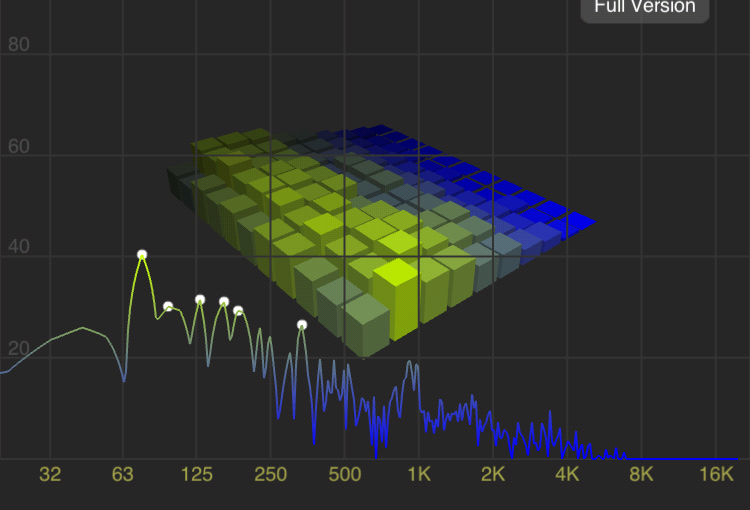

I hope someone could comment on my issue with my mcx-1 monos and my mcx-4.
I have a "to" loud buzz from speakers when the amps are powered up.
After long testing I have found.
Connected is, speaker+cable+mcx, when connecting rca the buzz starts and is there whatever is connected later, receiver TV Turntable....
4 different of rca=same result
3 other poweramps tested=no buzz at all.
Tested lifting ground=no improvement
Measured at 20cm distance.
Hope some of you can advise me.

No box.
Nothing in the wall except the poweramp.
The noise is there with hanging rca, not put in to anything, gets lower when i place the rca on top of the amp???
When connected to Marantz and Denon recivers pre out, increased.
