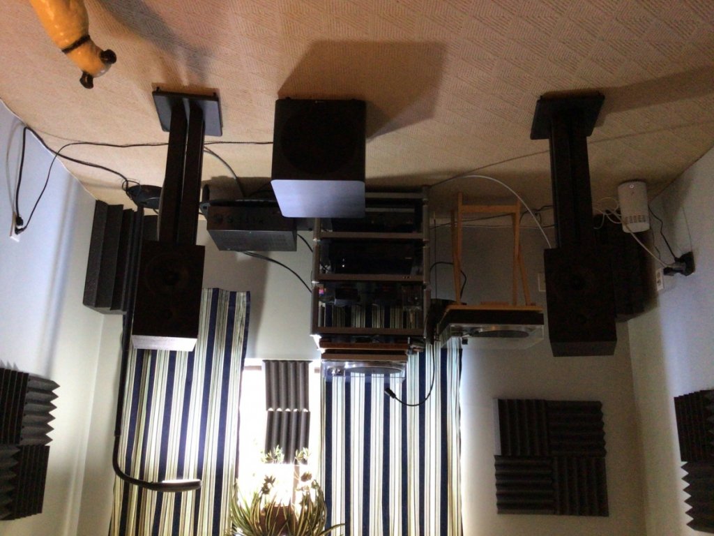

Need help to tame the bass. It is booming and not tight.  Tried moving speaker in my dedicated room. Any suggestions? Built crossover per Danny’s YouTube video. Has no Rez.

My room is 10’w x 15.5L x 7.5h. The speakers are 5’ from front wall and 32” from side walls to center of speakers.
My equipment is:
Yamaha AS-501
Onkyo C-7030
Schmitt Modi 3+
Technics SL-Q3

The sub shown is not turned on.
Why did my photo show inverted?
That happens to me when the size of the JPEG file is too large. If I save a copy of the file at 50% - 80%  of the size then post that pic it comes out right side up.

fsdaron
  • Posts: 59
Re: Bass not good on my xls encore build
« Reply #17 on: 7 Apr 2021, 09:51 pm »
Thanks Chris for the picture fix.
