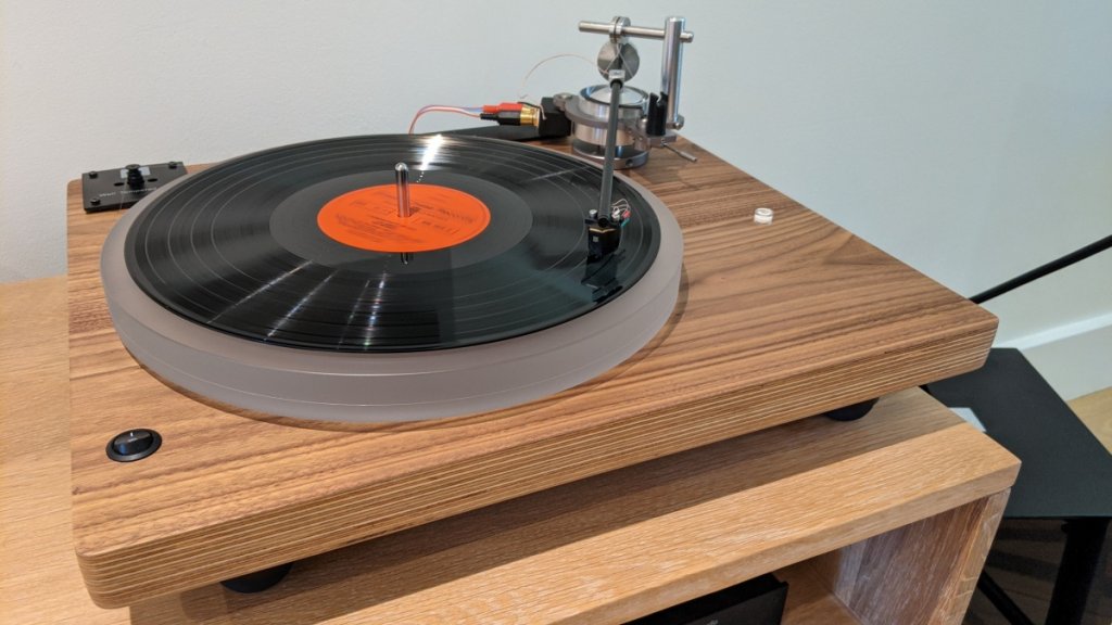

1 - My main concern is with the platter. When spinning (driven by the belt) I can see a slight wobble. Here's a video I made:
https://photos.app.goo.gl/coMpfzBmpwNvr4999
Reading other posts in this circle I started to think that maybe my belt was a bit loose/overstretched. So I made a new one (21 inches of diameter) but the result is exactly the same.
Of course I tried to reposition the platter countless times, keeping it from the spindle as suggested in the manual, but no luck.
I don't think (let's say I hope) this has any effect on the sound, but with my Rega (with an aftermarket machined subplatter and delrin platter) to tell if it was moving you had to touch it.
It's cosmetical, but it buggers me a bit tbh.

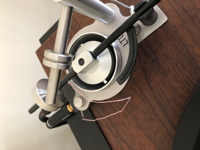

2 - I spotted something weird about the wire exiting the tonearm. You can see a picture here: https://photos.app.goo.gl/2jPCuFXUd6gDqT7K8
If you zoom in it look like some copper wire is exposed to me? Turn up the volume of my preamp and tried to touch it with my fingers and move the wire, but I could hear nothing out of the speakers.

Now this is me, I would never accept a wobble platter. AND, yea sure looks like bare wire exiting that tone arm wire.
Return the whole thing. Display demo or not should not be as shown.

« Reply #2 on: 28 Mar 2021, 02:12 pm »
Agree. My WTA Mark 1 shows no platter wobble.
Return it and either buy a new one or wait for a used one in excellent shape
BTW, my motor makes a racket when the thread breaks but is silent otherwise.
The Teflon bearing can be adjusted by finger but it’s tight. I don’t believe that is causing the turntable wobble.

« Reply #3 on: 28 Mar 2021, 03:07 pm »
Yep, I agree with G E and bacobits1. Sounds like a mildly abused Versalex. The flaws you speak of are unacceptable. Buy a new one...you won't regret it.

« Reply #4 on: 28 Mar 2021, 06:06 pm »
I agree with the above comments. I own a Versalex and have had zero issues. The platter runs perfectly smooth and level. The motor is noisy without the belt, but silent with one...even when I stand next to it.  Also, I noticed that the finish on your tonearm looks "grainy". It doesn't look right! Here is a pic of my tonearm for comparison.  There is obviously a problem with your table, so send it back.
