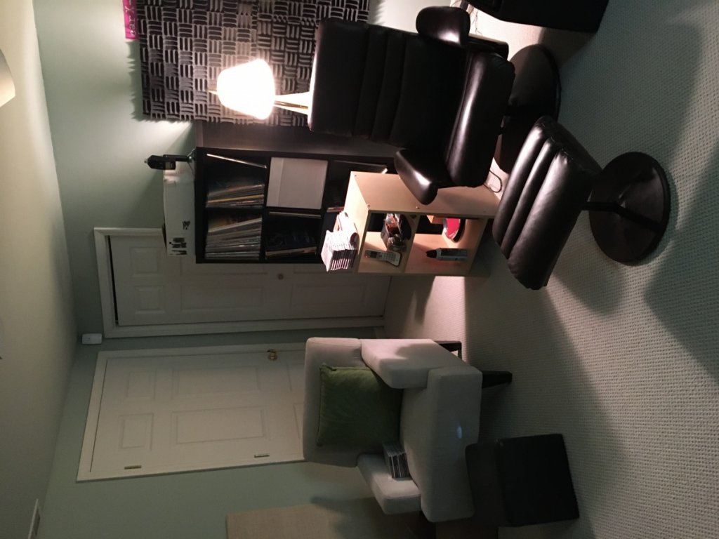

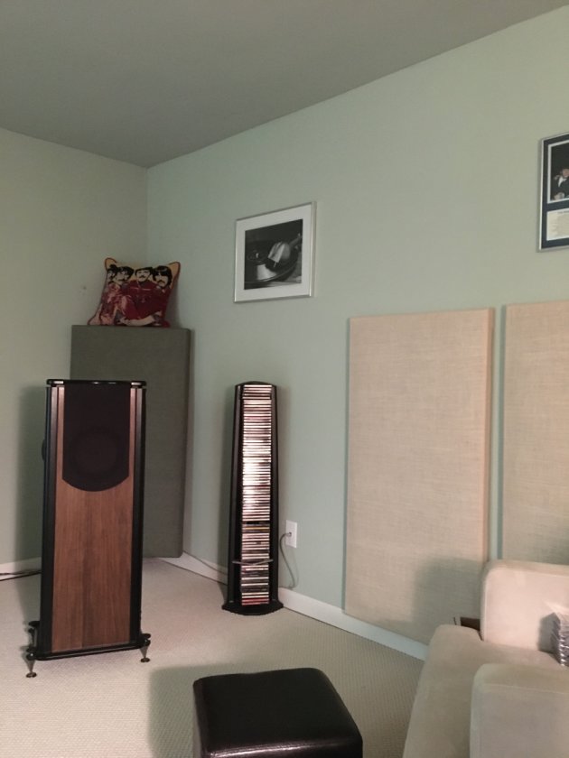

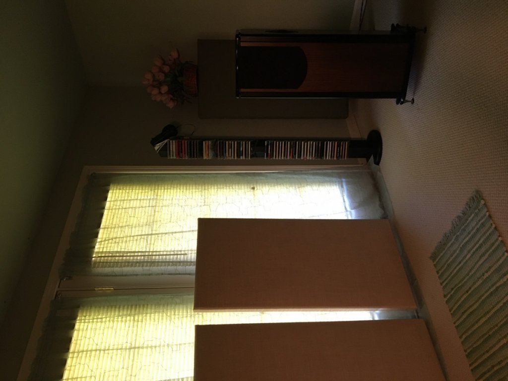

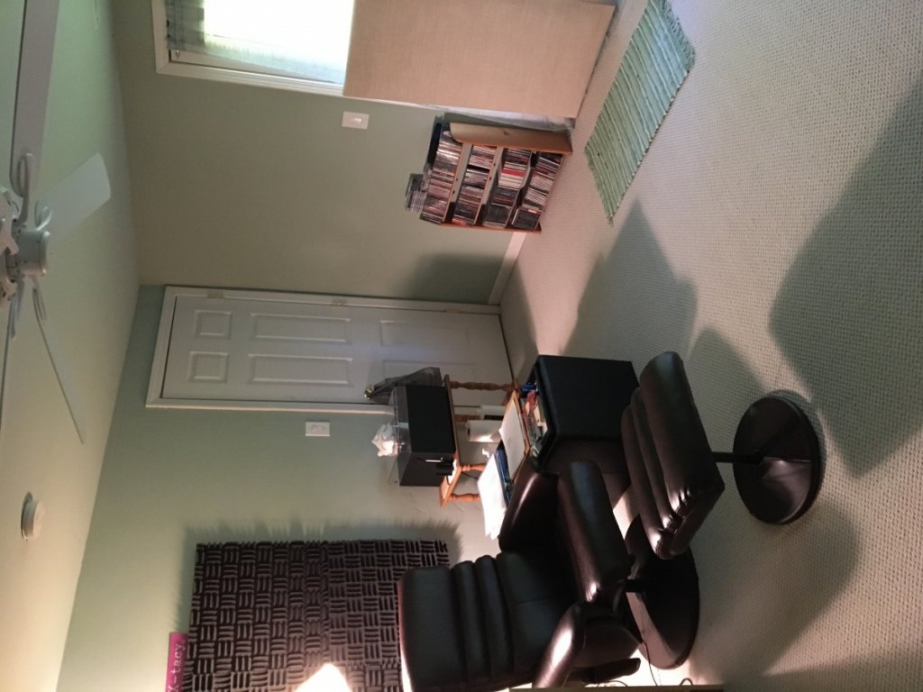

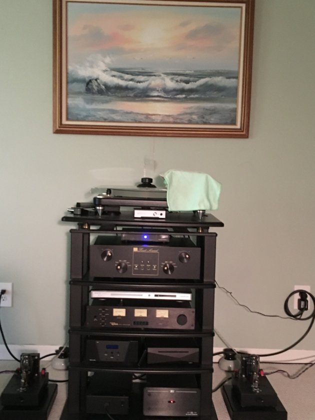

deauguie
  • Posts: 50
Re: New Listinging Room
« Reply #6 on: 28 Mar 2021, 09:33 pm »
OK...here’s what I’m working with:
Well...I don’t understand why some of these pics are rotated, but this is the best I can do.  My sub, an SVS 2000 Pro, was not purchased yet when these pics were taken.  Hope this helps.
