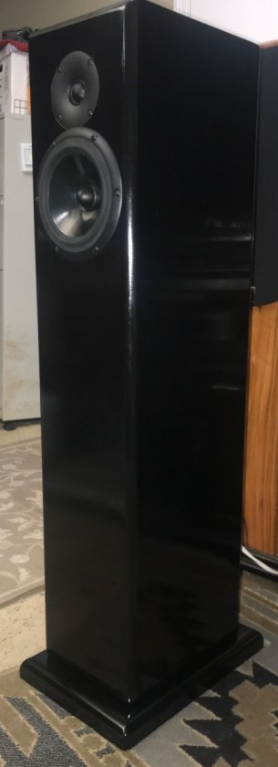

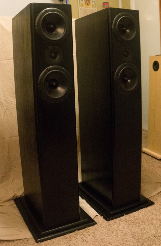

The X-SLS does not double the quantity of the mid-bass drivers. It is a two driver speaker just like the X-LS just in a bigger cabinet. The X-CS Encore doubles the number of mid-bass drivers compared to the X-LS Encore and it does have a different crossover. The floorstanding version of the X-CS Encore is the X-MTM Encore.
To summarize, the stand mount / floorstanding versions respectively are: 2 driver - X-LS Encore / X-SLS Encore and 3 driver - X-CS Encore / X-MTM Encore.
Here's an X-SLS Encore
And Here's an X-MTM Encore
