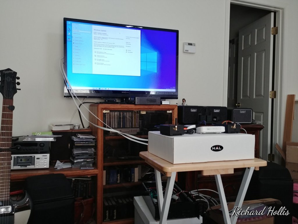

The HAL MS-6 I2S Bus audio driver test setup for trying out the system.  This way I can debug the Windows 10 device driver software as I make progress.
