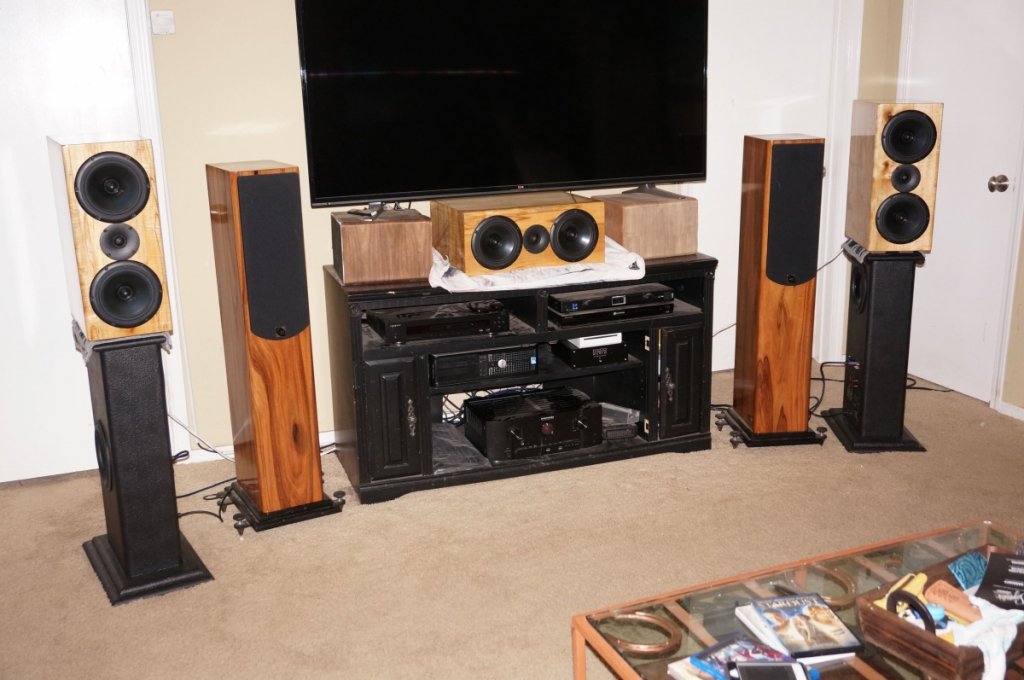

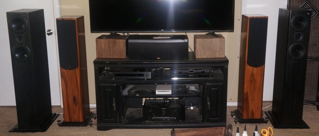

I’m not sure what N3s are, but I definitely have speaker envy.
So, based on the fact that these pics are all taken with the tv in the center, it seems like you’ve gone through some HT setups. Do you have any particular setup that stands out as a favorite?
Beautiful. I absolutely want to know how it turns out. And I feel the same way- high end speakers, then bring up the rest.
I’m actually wondering something else now:
If I have X-MTMs L&R, and X-CS center, they obviously have different roll offs at the low end. In the AVR, do I set the sub crossover the same for all of them? Or different for center vs LR?
And then I wonder if it’s better to go all X-CS up front with the same crossover?
Mlundy and corndog, you both mentioned all X-CS up front with a sub. Is that out of your guys’ personal preference? Or because that ends up being the most flexible or something?
The N3s are an MTM transmission line from Danny’s N series line which is currently out of production.
As for a favorite system, that has two answers. For normal use on a realistic budget it would be either:
Front -  X-MTM Encores with X-CS Encore center, or if you can get them at least 3ft off the front wall, my preference would be X-Statics with X-Voce center. Speakers fully lined with NoRez, upgraded crossovers, and tube connectors.
Surround speakers - A/V1-RS or if your room is big enough the surround speakers can be 3ft from any wall the X-Omni
If you have enough room to get all speakers 3ft from the walls: X-Statik, X-Voce, and X-Omni
If you can get the front speakers 3ft off the wall but not the surrounds: X-Statik, X-Voce, and A/V1-RS
If you can’t get either front or rear speakers 3ft off the wall: X-MTM Encore, X-CS Encore, A/V1-RS
Plus either one or two Sub Kit 2 in a sealed box(s).
Use the AVR’s bass management to set the crossovers for the speakers individually.

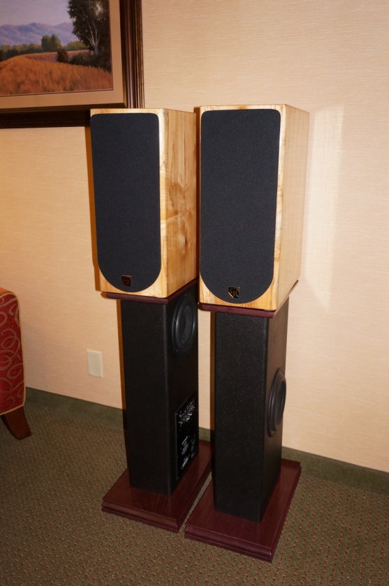

As for my personal favorite system, that would be the one in my man cave. This is a 4.1 system, no center channel speaker.
L&R main speakers - full range open baffle NX-Otica MTMs on top of dual H-frame servo subs
No center channel speaker
Surrounds - A/V1-RS
HT sub - Servo Sub Kit 2 in a sandbox cabinet.
This system has both two channel and HT electronics. For HT the AVR’s Left and Right preamp outputs are connected to the two channel preamp’s HT by-pass input which allows the higher end two channel preamp and power amps to drive the main speakers while the AVR drives the surrounds, HT subwoofer, and controls the volume. When listening to music the AVR is not turned on. This setup gives me best for both music and HT without having to change any wiring, Just Chang the input setting on the two channel preamp and pick up a different remote.
Sold! That's exactly the direction I was leaning (X-MTM, X-CS, A/V-1RS, Sub Kit 2). So the added recommendation pushed me over the edge -- thanks
Surrounds - A/V1-RS
:drool: :drool: :drool:
 :notworthy:
I'm hoping to get to a similar setup with preamp, amp + HT AVR. But that's a bit down the road for me, I think.
One day, I might be cool enough to sit in front of some NX-Otica's, lol. But I also think I need to train my ear a bit in order to fully appreciate them.
From what I've been getting, it seems that the GR speakers perform at a level that's about 5-10x their price point. So the NX-Otica's must be top top top tier, yeah?
