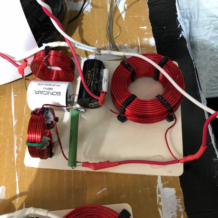

Do you have a photo of the crossover after it was together?

SVS Ultra cossover.

Nice work! Thanks for sharing the photo's  8)
