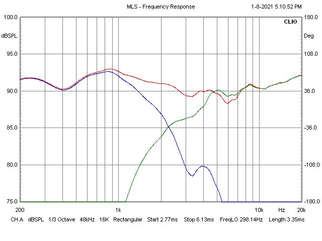

It's an edge-diffraction issue.
The bump is still visible in the original speaker in the crossover measurement, but it is brought down by the slope of the tweeter: (see the green line at 5Khz)

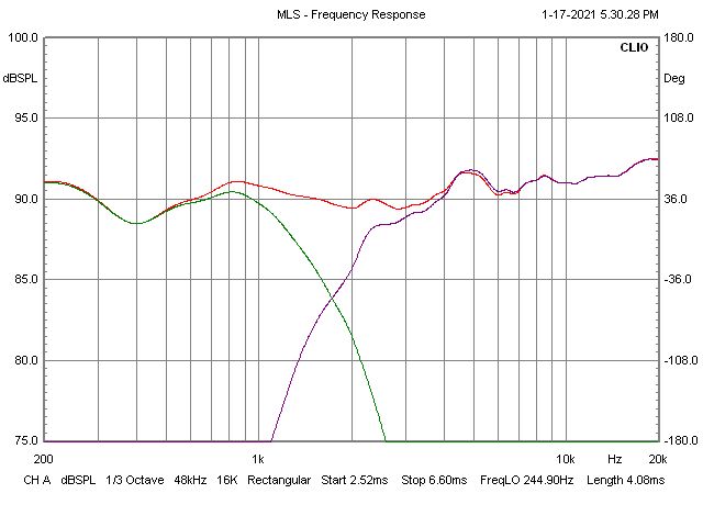

Upgrade On Axis:

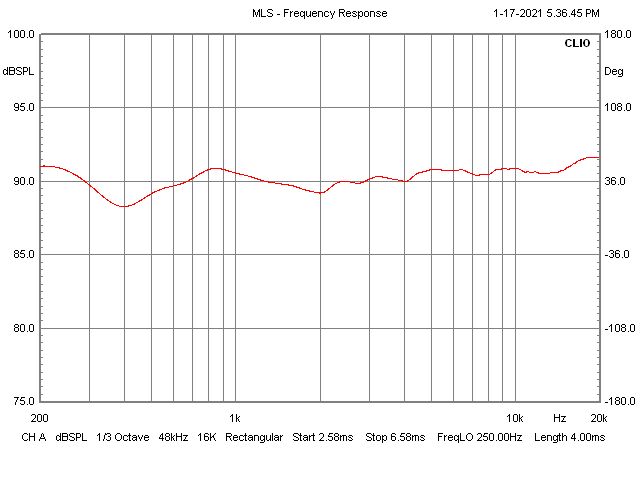

Upgrade at 10-degrees off axis: (5KHz hump is gone)
Most "Brightness" issues occur in the 1-3KHz range, most everything above that is harmonics and spatial cues and unlikely to be an issue unless there is a severe spike or breakup mode.
You can tackle the 5Khz issue by placing some 1/4" thick felt around the sides of the tweeter to absorb the reflection issue off the baffle, or keep the speakers pointed out past your shoulders.
