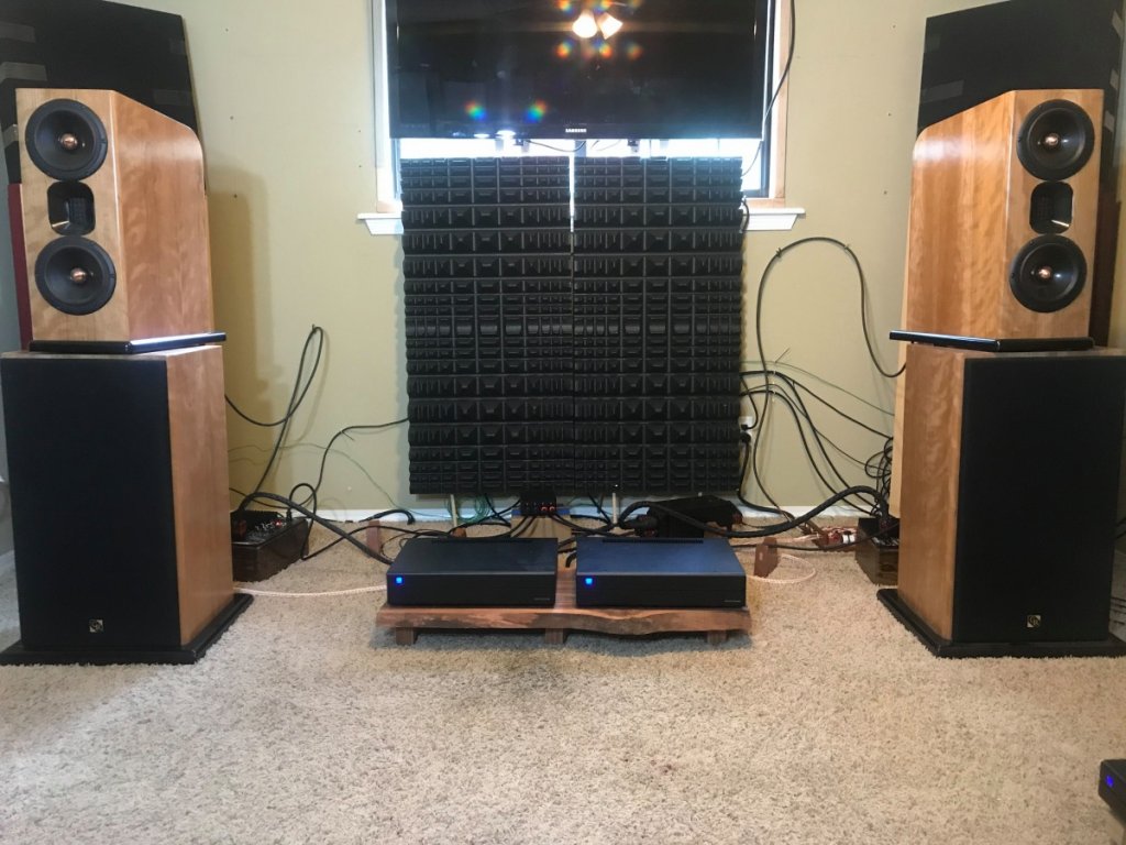

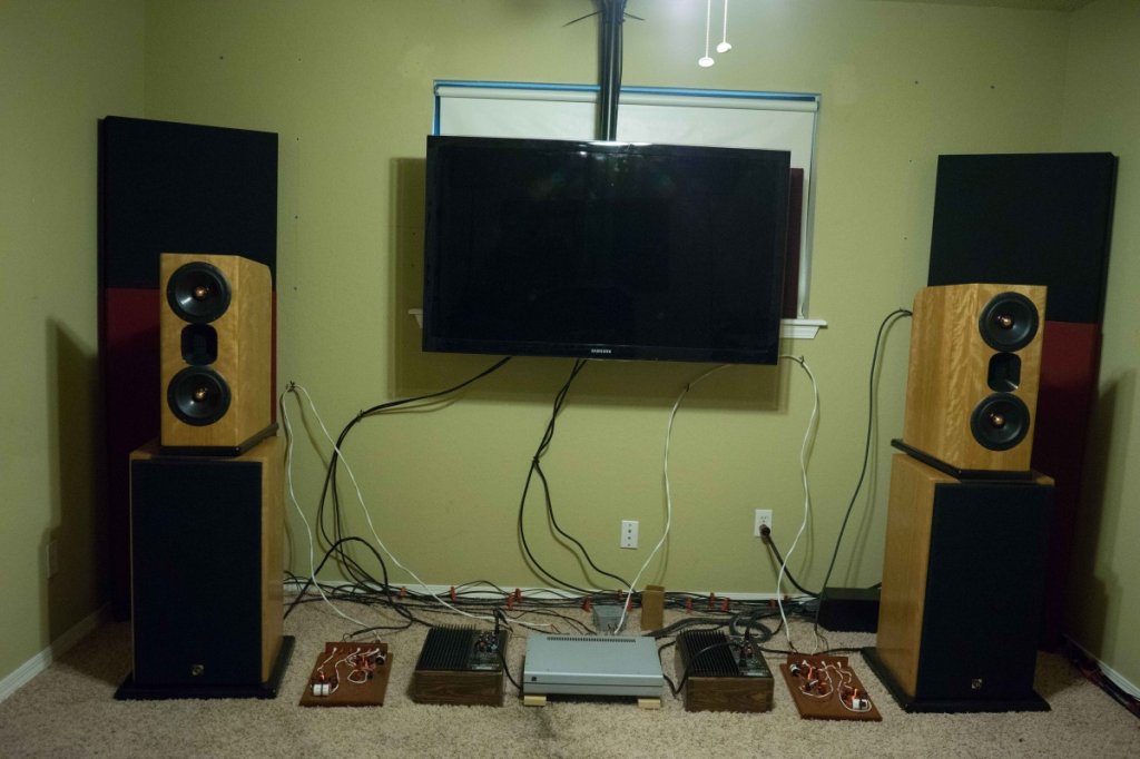

As for length of the speaker cables, it comes down to where you place the respective amps. In my setup, the difference in speake cable length between a stereo amp and a mono block would be less than a foot. In reality I used the same speaker cables so no difference there.
Stereo amp position
Monoblocks

That's the exact speaker set up that I want to build !!   :green:
Are those the x-otica crossovers on the floor ?
Where are they in the mono set-up ?
Yes, those are the crossovers. They are currently behind the speakers. Normally they are mounted on the base of the speakers. I just wanted to do something different
