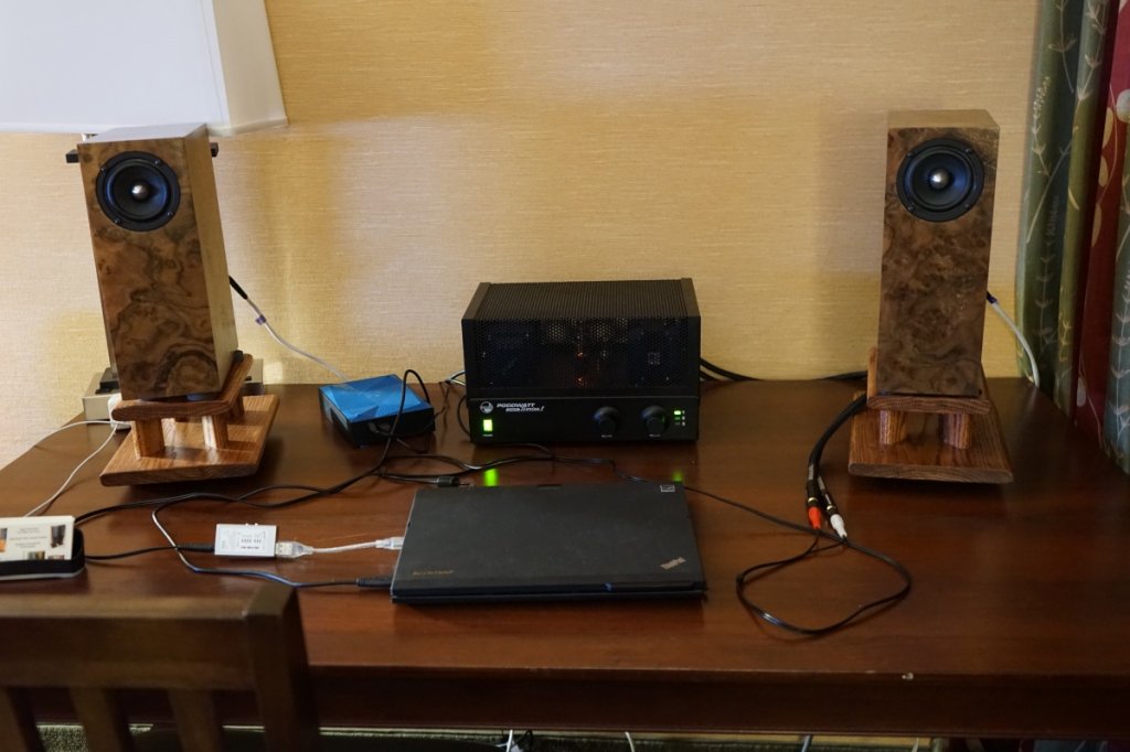

+1 on the LGK desktop monitors. That's what I use and absolutely love them. They tick off all your boxes except one. They fit well on a desk and don't take up too moch real estate, they sound fantastic, and don't really need a sub though they do sound better with one. I used mine for 3 or 4 years without a sub.
The one box they don't check off is they are not open baffle. In my case, my desk is too close to the wall for an open baffle speaker, even if it would fit on my desk, which it won't. This picture is from the Lone Star Audio Fest but my desk is just as close to the wall. Everybody who heard these were floored by their sound.
