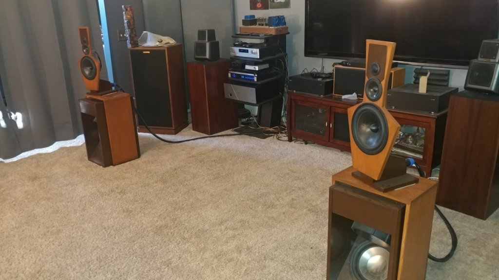

I already have endgame open baffle speakers.  I'm just looking for a stand mount passively crossed over project that is stand mounted and not a prefinished high end product if that makes sense.  I just enjoy building things during quarantine and working with my hands.
Here's my (dirty and a bit dusty) pair below, my finishing work isn't perfect but from a few feet away they look good.  It took me about 6 months to get them assembled and finished, mostly because Seas shut down for some multi-month European holiday and delayed the arrival of my woofers!:
