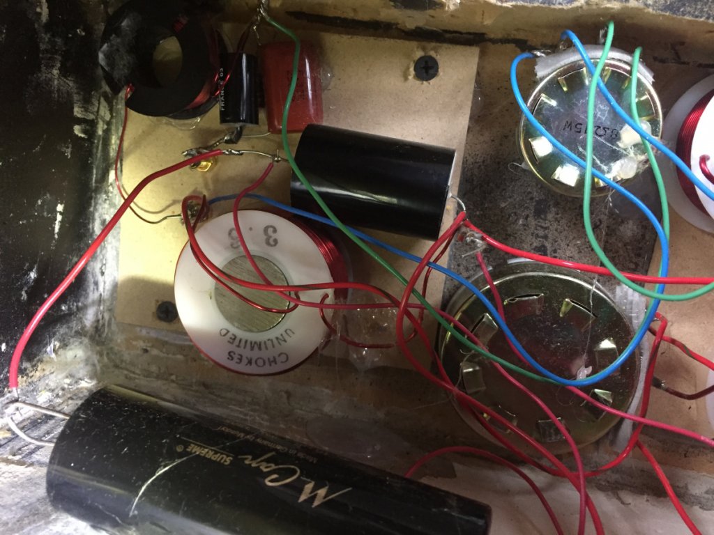

GeorgeAb
  • Posts: 400
Re: L-Pad
« Reply #14 on: 29 Dec 2022, 09:16 pm »
Congrats on getting your L pads replaced. The tweeter and midrange used in the RM series are both 8 ohms. The tweeter can be a smaller sized 50W and midrange 100W. That said no problem using 100W (the larger sized L pad) for both the tweeter and midrange as long as rated for 8 ohms (not 4 ohms).
The way the L pad functions (discussion here: https://www.diyaudio.com/community/threads/8-ohm-l-pad-total-resistance.130760/#post-1623893 ) it is important that leg 1 (on left when you look from back of L pad) is connected to low side (blue for tweets and red with stripe for mids) and leg 3 (on right) to the high side (green for tweets and red for mids), with mid leg going to speaker driver. You may want to double check position, but likely you put them in like you took them out, but good to mention for reference. Couple pics showing what I mean.
On my RM-60's I have the tweeters pot all the way CW. When I check with Room EQ Wizard that position provides a response that is closest to the room curve (perceived flat at listening position). I do have quite a bit of room treatment which attenuates higher frequencies more than lower.
