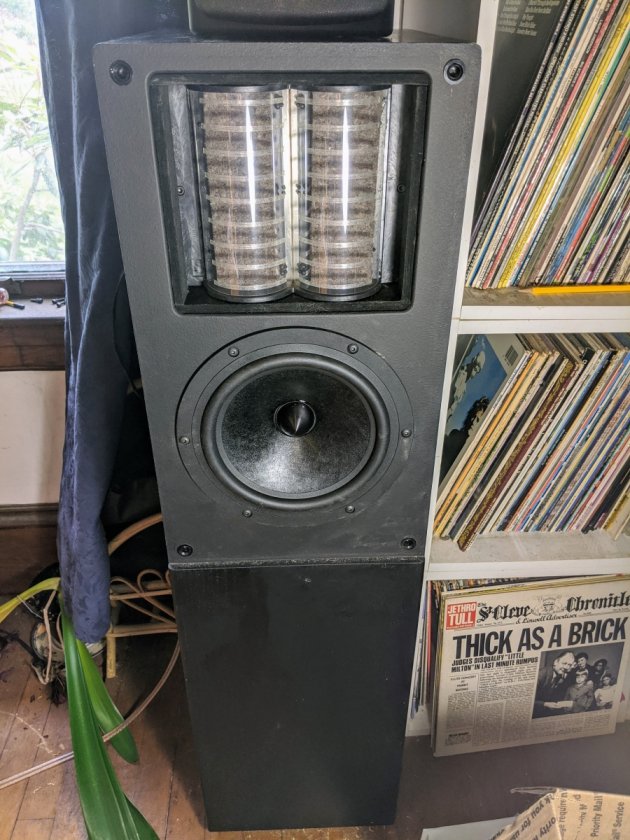

The ability that an active crossover has to make fine tuned changes like shifting the crossover points by 5-10 Hz at a time, until things gel. I should mention that the Linaeum TLS tweeter is crossed in at 440Hz, and I have the Dayton Audio RS225P-8A crossed out at 400Hz. I had it at 410Hz for a while, and vocals were just a bit too congested. I will live with 400Hz for a while, and then maybe try it at 390Hz.

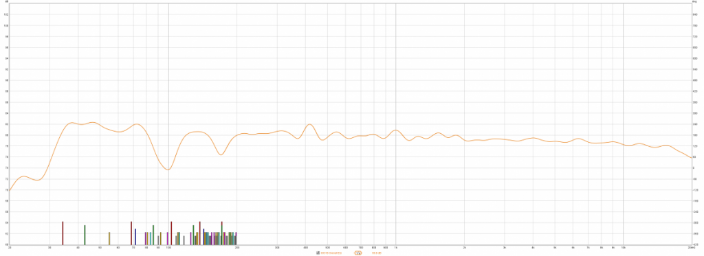

And the driver filters are amazing - you can aim for perfectly flat response, if you want to. The TLS tweeters are about 10dB louder than the woofer, so even though it rolls off a lot above 10-12kHz, it can be made nearly perfectly smooth. I have gone with a "house curve" which is a mild Harman curve. Flat between 200Hz and 1kHz - below 200 rises 1dB/octave (so +3dB at 20Hz) and it drops by 0.5dB/octave above 1kHz )so that is -3dB at 20kHz).
