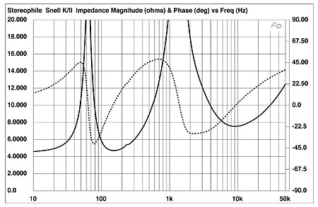

Snell Type K
Could only find the impedance measre of Snell Type K/II. If we assume that the curve is similar, this speaker is not well suited to a high ioutput impedance tube amp. You will likely hear that huge impedance peak at the XO.
If you ar elooking to an SE amp, more suitable speakers might be appropriate.
