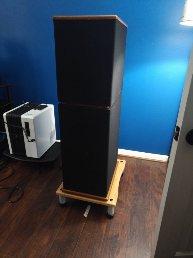

Looks like I found the "vanishing point" for the 33's in my room.  100" between tweeters, leaving 34" from each tweeter to the side wall, and 7 to 9 inches from the back of the speaker to the front wall.
Practically impossible to place the sound on the speakers.  It's wonderful!
I did bring the VR-4's upstairs and have given them some play time too.  They are amazing in their own right, but I find the highs a bit brighter (by no means unpleasant though).   Albert's design choice of using low woofer to mid crossover points really shines through, in the case of both models.  Even nearfield you just hear an image, and not drivers.  Both speakers present the illusion of music suspended in space.  Consigning the VR-4's to living room duty is almost a cardinal sin.... but I wouldn't have space otherwise for my primary speakers.
Just between the two models I'd give the VR-33 the win from top to bottom.  Less brightness in the highs, and the D'Appolito arrangement with larger drivers really puts impact into voices that's not as pronounced on the 4's.  Even though the VR-4's do bass MUCH better than any other dual 8" speaker I've ever heard, the 33's still win out.  Granted they are designed (like the Allison's) to use the room boundary to enhance the bass, so maybe that's a cheat on their behalf.  :P  The 33's are also considerably more efficient, as they are notably louder at identical volume settings even though being over 40" father away than I have the 4's.
Ha, listening to some music while typing this, I just heard a live passage where the clapping left a small hole in the center in front of the stage.  Guess I'll slide the 33's a couple inches inwards and fix that.  This is fun!

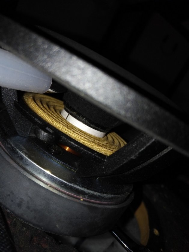

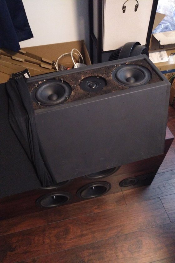

Audio nirvana has been put on hold...
I had gotten the VR33 placement just about right, a few days ago.  Was listening to them and I thought I head a buzzing sound.  Since it was music I hadn't listened to in depth before, I chalked it up to a bad recording and moved to something else.  But I started to notice it in familiar music too.  I began playing a sweep and put my ear closer and could hear that the lower midrange driver was having a really hard time.  :o
Thus, I had to troubleshoot... and that meant rolling down the sock.  Ugh.
There wasn't anything visibly wrong, so I pulled the midrange out.  This was something I've never seen before.  The glue adhering the neck of the cone to the spider had completely separated.
The buzzing I heard was due to lack of suspension.  I went ahead and checked the upper midrange and the adhesive had also separated.  The difference being that a little "lip" of hardened adhesive had kept the spider from completely sliding free, which kept the coil from rubbing the magnet.  Still... yikes.   :icon_surprised:
I was explaining to my wife that such a thing just doesn't happen, like almost never.  To show an example I grabbed one of the Allison CD-9 woofers and showed her how a 35 year old speaker still had a firm spider to cone grip.  Who knows what happened with these midranges.  Bad batch of glue?  Assembler came to work drunk?  The mystery will never be solved!
I got some epoxy and repaired as best I could.  It's a very tight space but I hit them all the way around.  Reinstalling and vigorously testing the drivers showed the buzzing was gone, so I guess I did a good job.  Still going to let the speaker sit horizontal for another day.
I hope the other speaker doesn't share the same fate, but if it starts to buzz, I know what must be done.

Oh and while I'm thinking about it... what's a good adhesive to re-attach the sock to the top of the speaker?
