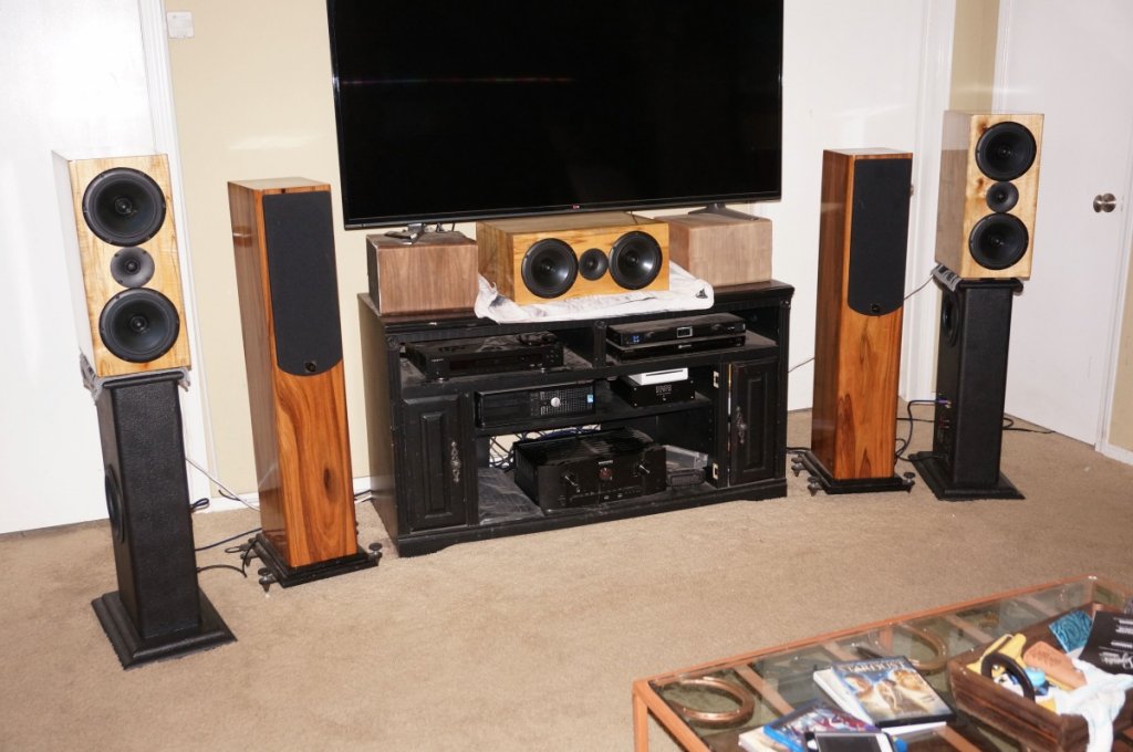

I agree with the sealed servo sub for HT. That's what I use in both my systems for the LFE channel even in my man cave system which has OB main speakers, the ones in my avatar. The living room system is still very musical even with the sealed servo sub carrying all the bass duties from 40Hz on down from the main speakers (N3 towers in the picture) as well as the LFE channel for HT.
The X-CS Encore is the center channel designed to go with the X-LS Encores. Though I actually prefer three X-CS Encores across the front in an LCR setup. The CS doesn't play as low as the LS as the CS is sealed instead of ported but the sealed servo sub(s) have no problem blending the the CS. On the plus side, the CS has higher sensitivity, a fuller midrange, and can be placed closer to the wall than the LS.
Here's a pic of three X-CS Encores in an LCR configuration
You can't see the sub in the picture because it is behind the sofa

Another idea I hadn't considered.  At that point it's almost like a bookshelf MTM with a sub under it unless I'm missing something.
Noob question: are there issues to consider with putting the speaker directly on top of the sub other than some vibration isolation?  It looks like you have a real high tech solution between yours.
That gets me thinking of my rears question.  Would it be better to put the rears on subs, then do either X-SLS or MTM with and X-CS up front?  Or do the subs really work that much better as part of the front soundstage?  Obviously, room acoustics start to play a big role here as well.

Those stands are really midbass drivers which extend the X-CS Encore front L&R to 30Hz. There is still a sealed  sub in that system for HT use or the mains can be crossed to the sub at 40Hz in the AVR if you listen to music with a lot of low bass like organs or synths.
You can use just the CS Encores on speaker stands then place the sealed sub(s) where it/they give you the best bass response at the seating position(s). Often the best spot(s) for HT subs are not going to be where the main speakers are. This position flexibility for best results is an advantage that satellite/sub systems have.
