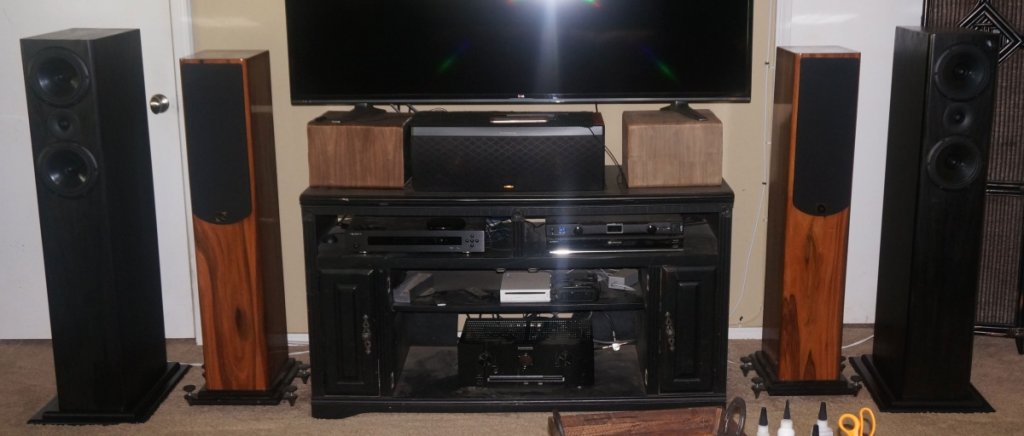

The X-MTM has a higher sensitivity, fuller midrange, and plays lower compared to the X-SLS. The X-MTM is designed to be -3dB at 40Hz but, depending on room gain, can play down into the mid to low 30's.
If you can get the deep back cups the N3s are an option. They are physically smaller compared to the X-MTM Encores. Here's a pic of the two side by side:
Both the N3 and X-MTM Encore are excellent choices especially if you upgrade the crossover parts.
[img]removed
