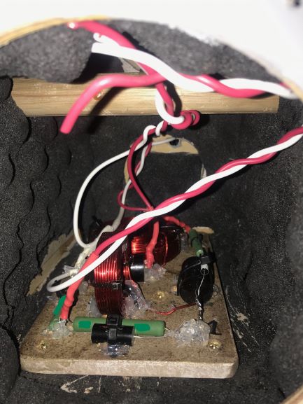

Crossovers and painting next.
Add polyfil, screw in drivers and polish..
« Last Edit: 19 Oct 2020, 11:32 pm by Speaker Challenged »

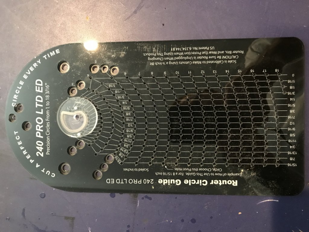

The best circle jig I've used is by Jasper. They have a few different models to choose from. I got mine from Amazon.
Here's a picture. You should be able to see how it works.
Hollis Prince
Re: An Australian take on My first XLS Encore Build OCT 2020
« Reply #19 on: 5 Jul 2021, 01:29 pm »
There's a alignment tool to get it perfectly centered on your router. Hole sizes in 1/16" increments, and they are spot on. The problem I've had with other circle jigs is that it's always just a little off. So then I have to adjust, cut a trial circle, adjust, cut, etc. until I get it right. With this style jig you'll get it right the first time if you set it up properly (which is very simple and easy).
