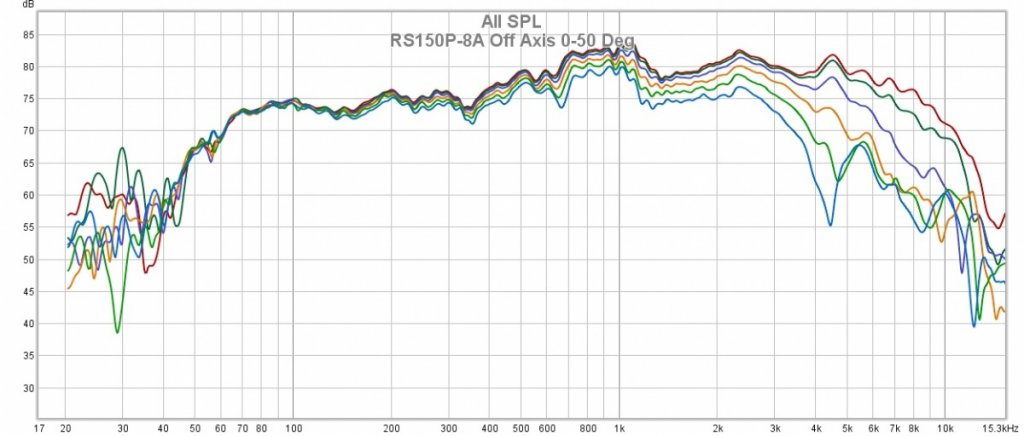

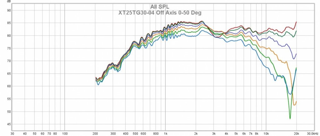

I am currently building a 2-way bookshelf speaker using the following drivers:
Tweeter - Tymphany (Peerless) XT25TG30-04
Woofer - Dayton Audio RS150P-8A
After chasing down the cause of some anomalous measurements on another forum I have finally convinced myself that I am taking good off axis measurements. At this point I have built two test boxes both full mockups with bracing, damping and rounded baffle edges. My goal here was to read the native performance of the speaker before crossover rather than relying on manufacturer's response charts and simulated diffraction.
First question: Is this recommended/ beneficial or should I be starting with manufacturer's specs and using the simulated baffle effects?
Measuring your drivers yourself, in the actual cabinet, after break in is vastly superior to designing a speaker using the published data from the mfg. Those data might be 20 years old and the mfg process "refined" in that time so that the data are not accurate anymore. Every speaker guy knows that the real data never exactly match the published data. You need the most accurate data possible so that your crossover design works in the real world. The math in the sim assumes T/S specs are accurate.

I have been really trying to take into account the off axis response as is recommended by Dr. Floyd Toole.
Hi, you may want to address the tweeter in the 3-4k area before the actual crossover. I'd guess it's a cabinet effect although some tweeters seem to be more sensitive to it than others.

I'm not sure about crossing over a standard tweeter at 500hz.  Most can't take the power and will be producing extreme distortion unless you have a horn/waveguide.  If you use a 2nd or even 4th order slope, you will still be playing your tweeter at significant levels at 150hz.

I looked a little closer at the Peerless tweeter you are using, and it is the dual radiator rings that are what makes this driver unique. Instead of trying to act like a piston, the soft rings each have waves propagating in a concentric pattern, and so they act closely similar to a point source. And they prove more surface area than a 1" dome, so they can drive more air. There is a lot to like with this tweeter.
Tekton Design has used this driver (I think) in some of their speakers. Having a 0.4 gram driver for most of the midrange - and seamlessly covering all the treble; is amazing. I am very tempted to pair this tweeter with a Seas U22REX/P-SL 8" Curv Cone Woofer (only 19.8 grams), in a transmission line cabinet ... (This Seas woofer is the only 8" woofer that I have found that is lower mass than the Dayton Audio RS225-P 8A, which is 23.6 grams.) And by the way, Tekton has also used the Seas 8" Curv Cone driver, in one of their speakers, as well.
The Dayton Audio 6" woofer that you are using is just 6.9 grams Mms. So the total moving mass of the two drivers is just 7.3 grams. That is pretty phenomenal.
This particular Peerless tweeter is not "standard" - it has a free air resonance of 436Hz, which is far lower than all but a very few tweeters, as far as I know. (The lowest I know of is the latest driver designed by Paul Paddock, called the WBLS (wideband line source) than is crossed over at 100Hz (!!). The MC Audiotech Forty-10 uses 10 of these - and crosses them over to a pair of 18" woofers, in an open baffle cabinet.)

Sure, but it's still a small 1.4ish inch radiator with 0.5mm xmax.  I don't think it's going to be too happy taking all that power down that low.  Well, I'm no speaker designer, so don't mind me.
