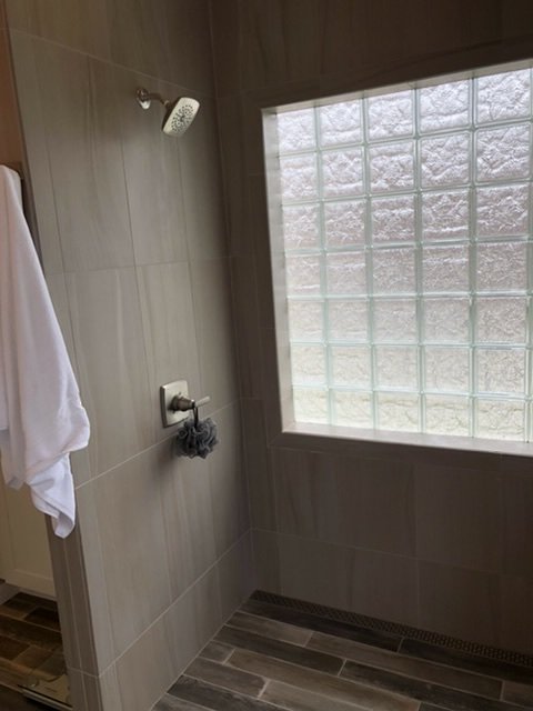

We have had an open shower for a couple of years. We also love our heated floor. The bench at rear of shower is really nice (not in pic). Also linear drain below block window.

Our floor slopes slightly toward the block window from about four feet out then waster goes out linear drain. There is no lip. The whole 8x8 room is totally waterproofed using the Schluter System. The tile is porcelain and the vanity top, shower, bench, and storage cabinet have quartz tops.

Plus 10 on the glass block in shower area. We took out a regular double hung window and put in the block.
