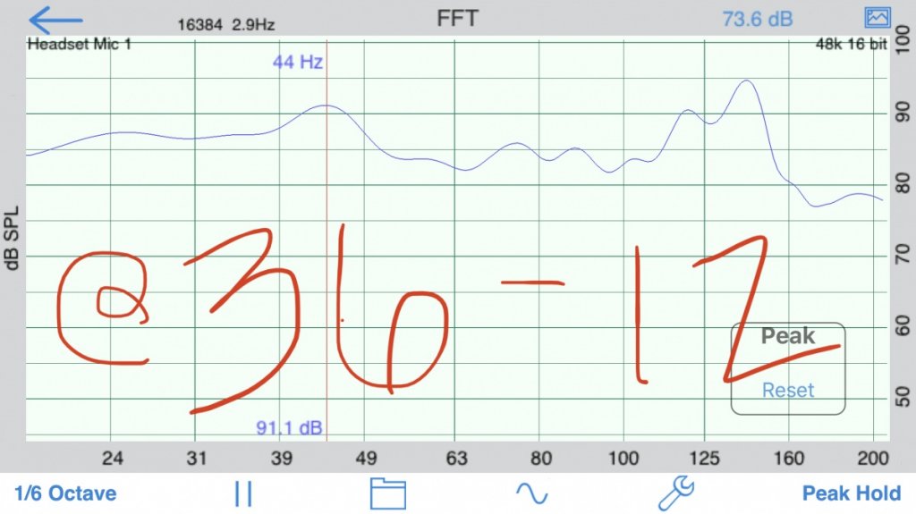

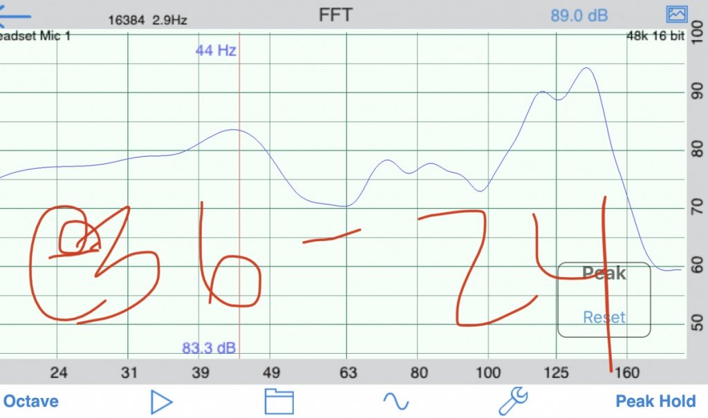

I did some sweeps with the subs crossed at 36hz. I did both 12 and 24db slopes. Not too much difference. I feel like 44hz is a room thing. Seems to always be there.
Both subs on the front wall. The right sub is facing right, left sub facing straight ahead.
12db slope
24db slope.
The volume was not changed so I cannot understand the difference in volume. That’s a mystery to my ignorance.
So I feel like I should go back to the 12db slope and acknowledge the 44hz peak but look past it and bring up that trough above it. What’s going on at 125 I have no idea. 63hz is always the low point in that part of the frequency range. No idea what to do about that either. Maybe this is the point where I run the full
Frequency sweep and then play with reflections and then dive into a mini DSP?
