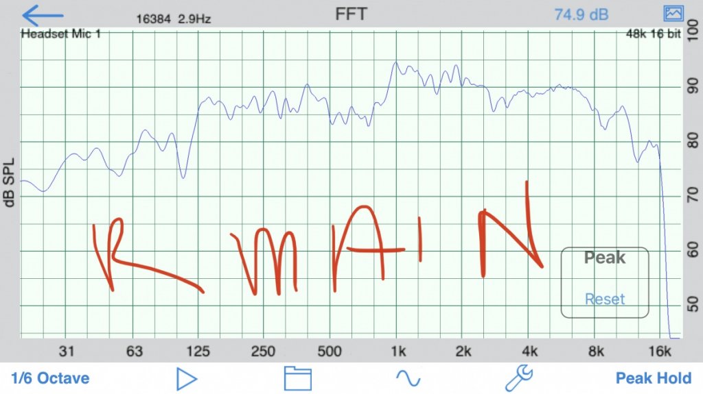

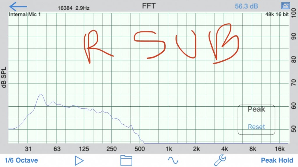

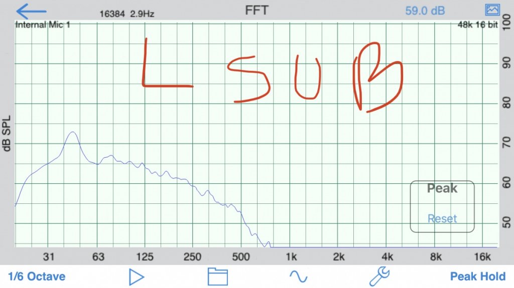

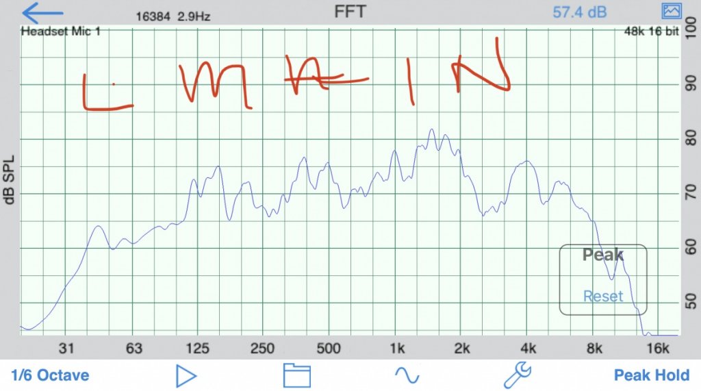

Ok so 4 quick sweeps.
Left sub (0 phase crossed at 38hz @12db slope - forward facing)
Right sub (0 phase crossed at 38hz @12db slope - right facing)
Left main
Right main
4 back to back sweeps of each speaker as they are set up now.
EDIT: I just realized I had fabric stuffed in the port of the Heresys when I was trying to blend them. Damn.

Looks like the main speaker balance knob got bumped.  :icon_surprised:
I'll bet my old JBL L100 speakers have the same rock and roll 45 Hz hump and they sound great.

Actually I don’t have a balance knob. I honestly can’t account
For the volume difference. Playing music music now and I can tell you there’s no 10db difference.
I have seen this on my sweeps so I wonder if the mic isn’t great or...
When running the left main (which has a side wall 3’ away I could detect pressure starting around 36 hz

Maybe your speakers are very directional.  If so, and the toe-in isn't symmetrical, it could show up as an issue in the measurements.  AFAIK, you probably want to do a gated sweep if you really want to see the speakers performance without room effects for troubleshooting purposes.  The subs actually look great except for the peak.  Since those are sealed subs and I'm assuming no weird EQ shenanigans, that has to be a room mode, not a sub design issue.

Don't your subs have a built in EQ?  Most do, and they are useful for knocking down a peak like you are seeing.  The peak at 45 hz is clearly a room mode since it shows up on all your graphs.
