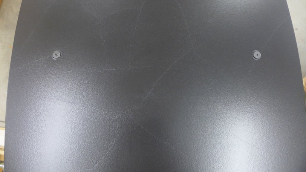

I would encourage you to let the Duratex thoroughly cure (not just dry) before top coating. The acrylic coating theoretically should be fine, but because bonding of most acrylics is primarily a mechanical function, you wouldn't want the Duratex to be curing after topcoating. I might even run your finishing schedule by the the manufacturer, whom I've spoken with and could shed light on any limitations.
I've attached a photo of something similar I did, but in all honesty I think I probably topcoated with something other than water base. It took some years to show up and the cabinets were in storage so I don't really have a timeline or even exact finishing schedule. I just don't remember, because it didn't concern me when I did it. Again, I think a conversation with the mfg. would be prudent.
Thanks, I'll do that!
