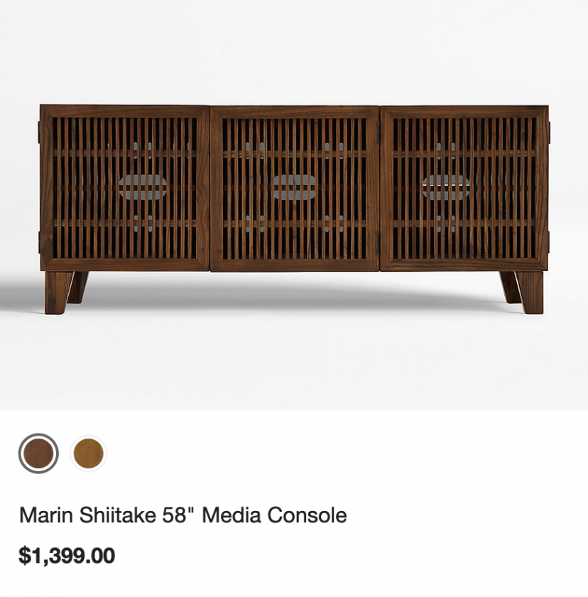

Does anyone make racks with front doors and open backs? Or alternatively, you could cut a round hole and install/fit in a small computer fan.
I have our second system in the living room inside this one from Crate and Barrel. The alternating wood strips effectively hide electronics while allowing for air flow from the front. It has several wiring/vent holes already cut in the back and I used a hole saw as needed to add additional wiring routing. I have an 80mm computer venting in the compartment where the amp is located. The only issue is that you have to make sure your components will fit the width on the right side compartments.
