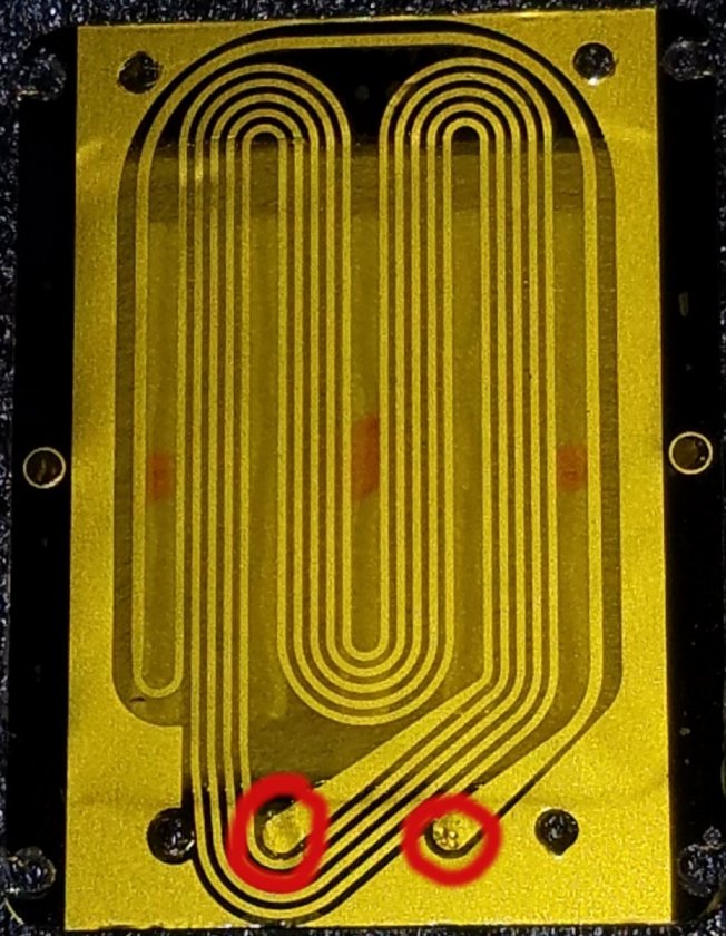

Okay, it doesn't look like I can get to the wiring/voice coils without likely destroying the Neo3. Pics included so that you can see the red circled areas on the film side of the Neo3 that appear to be where the terminals lead to or terminate at. Also note the terminal side adhesive, and the sandwiched part of the terminals that is adhered with what looks like glue, is only between @ 1/8 inch and 3/16" thick. I cannot make out any wires that can be accessed from either side of the Neo3 since they appear to contained in the terminal sandwich area.
It looks like an easy repair is unlikely, so I will have to get a replacement Neo3 from Danny.
Red circled areas that the terminals lead/connect to:
Terminal sandwich + adhesive:
