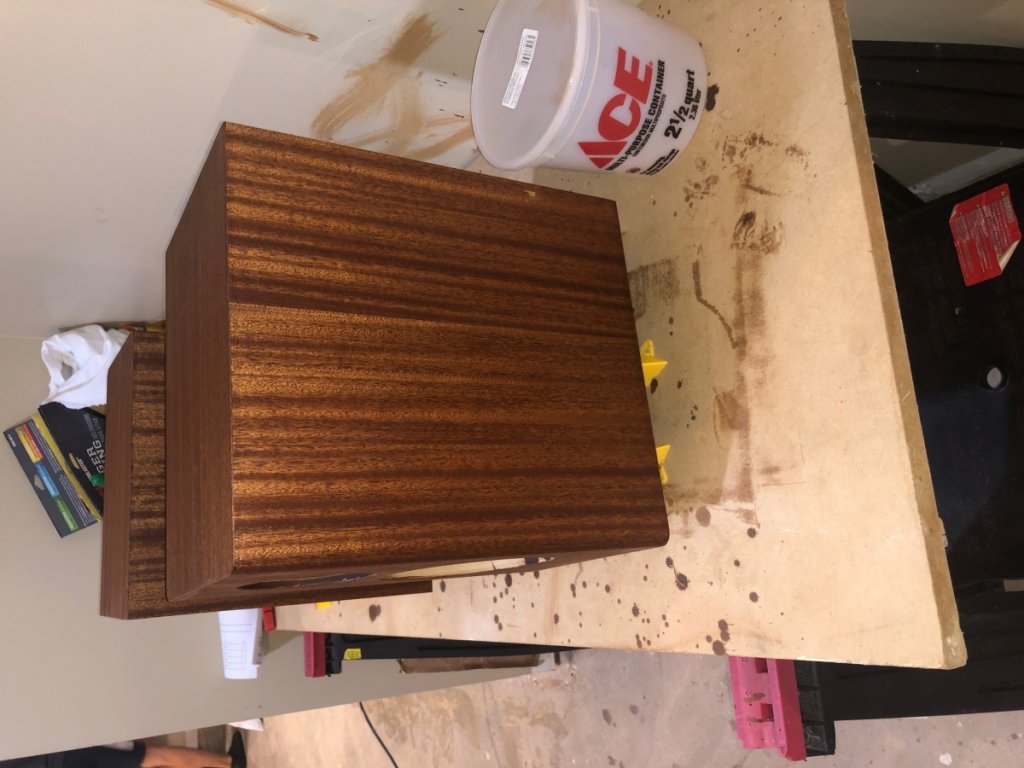

My oldest boy stained our speakers by himself with Mohawk Radiant Copper.   All that has been done is the staining process and we really like where the speaker is headed.  He was very proud that he was able to do this and made for a fun day.
Cheers!
Those are looking great! He nailed it! :thumb:

My oldest son now has 7 coats of tung oil. We used gray scotch bite between coats and 600 grit wet sand/slury with application of tung oil.  I figure we will keep adding layers while we wait on our tube connectors/foil inductors with the rest of the kit to ship.  I figure we can always take some 0000 steel wool at the end to get that more satin finish. But my son has really been patient (rare for 14 yr/olds) and is proud of his work.  It has been fun for us so far!

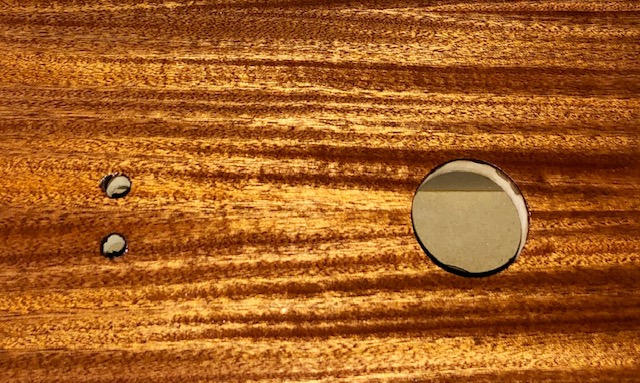

The first is the picture of the two with 7 coats and ambient light in my basement where i can keep humidity and temp constant.  The second close up is with direct light on it.  You can see how the grain glows with light.  The copper stain from Mohawk did wonders.  It might not suit everyones taste but we are happy that we have made it this far.

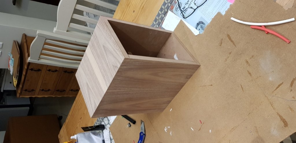

Wow - that does look great  :thumb:  I am at a similar junction - knew nothing about veneering prior to this, but I think I did a much worse job than you did. I have a walnut veneer and am struggling to get a nice finish. Best test so far has been a regular varnish but I am definitely looking into the Tung oil.
Here it is as it currently looks - part of me likes the dullness, I am afraid that once it shines, the little bubbles will be visible. I'm not sure about a stain yet, I do like the natural colour.
Do the multiple layers just make it brighter, shinier with every layer?
Looks good to me!  We are complete novices here too.  We just watched lots of Peters videos many times and as many other videos/reading as we could do our best....no where near perfect by any stretch but our best.
I am not a wood working expert so I would wait for others to chime in on finish.  My experience has been that the Sutherland Wells tung oil made the grain really pop in a beautiful way.  Also, because it is a penetrating oil, it is easy for beginners to apply.  Wipe on.  Wait 30 mins. Wipe off.  Light sand between coats to know down dust nibs and repeat.  We ended up applying 10 coats to get a nice finish that enhances the look without completely filling the wood grain.  I have read that some woodworkers will go between 10-20 coats.   It is easy but you have to wait 20 mins between coats for it to dry.  Final curing takes months from what I have read.

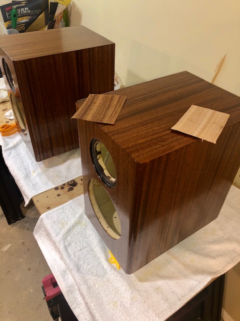

Here is a photo of my X-LS encore with 2 pieces of veneer sitting on top.
1.  The square furthest away in the photo has one coat of tung oil and nothing else
2.  The second square closest to the camera is bare veneer
My boxes now have Mohawk Radiant copper stain with 10 coats of sutherland wells tung oil.  Many days of slow and easy work.  It was funny, some days the coat would be ready to sand within 24 hours and have that fine white/powdery residue. Other days, it would need a second day.  Either way, we remained patient and only moved forward when the tung oil was dry.
Take a look:

Naboo, walnut comes to life with a hint of orange in the finish.I suspect Tung oil would have a pleasing result as would most oil-based finishes. They almost all impart a slight amber hue. Penetrating finishes will tend to leave that "woody" look that many like.
You mention bubbles, are there bubbles in the veneer? If so, that would be something of a problem that could perhaps be fixed. How did you apply veneer? Paper backed or raw? Many here to help, but perhaps best to start another thread.

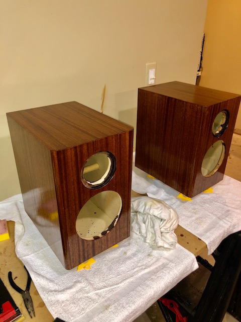

Finished and breaking in.  The boys keep going back into the room to look at them and admire their work.  Thanks to the community for all the help.

Looks great!  The shiny screws give it a little class too.  :thumb:

Love the touch with the gold/brass colored screws, I did the same with mine! Plus I saw Danny's XLS build guide, he sprayed the screws a copper color, & that was a fantastic touch too.
