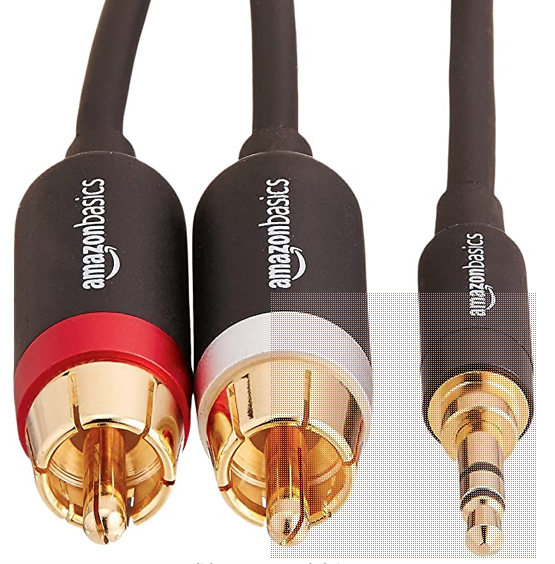

would have been ideal if the BHA-1 had 1 more input to add a DAC (and keep the tuner).
Don't forget the 3.5mm input jack on the back of the BHA-1. I know most audiophiles wouldn't let anything from amazon near their hi-fi, let alone something with the words AmazonBasics on it, but this cable is decent and will give you the extra input. I'm sure you can find higher grade 3.5mm to RCA cables if you search. Anyway, my point is that there are three inputs and you don't have to be without in your case.  I would move the tuner to this input and the DAC to the RCA.

Thanks for the suggestion on the 3rd input. I will definitely do that. The tuner connected to the BHA-1 is good but not as good as what I have on system #1 so it does not have to be the best connection.
