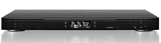

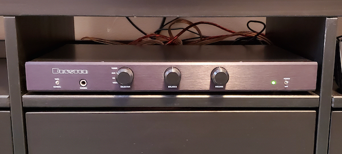

My B60 is living in fairly tight quarters these days.  I have enough space on top, but the sides only have about a 1/4" of room on each side. I haven't had a thermal shutdown yet, but the unit does get fairly warm. I stumbled onto this cooler at Amazon and started thinking it might be a good idea to cool the B60.
https://www.amazon.ca/dp/B078PQJSRY/?coliid=I3KWKL3KQS4VJ&colid=MIQWLSL1K4D&psc=1&ref_=lv_ov_lig_dp_it_im
What do you guys think?  No shutdown, no worries, leave it be?   Or will cooling B60 help prolong the life of the unit?  I would run the fan at low speed as I definitely don't want to hear it. If you have used this cooler or anything similar please share your experience with it.

So last night I moved the B60 to the top of the cabinet. Being low profile it slipped in under the TV.  I measured the temp this morning after leaving the unit on, but not playing anything, all night.  It registered 35C 95F.  Only 3C 5F degrees less than in the cabinet.
I don't know what normal or acceptable operating tempter is for the B60 is.
