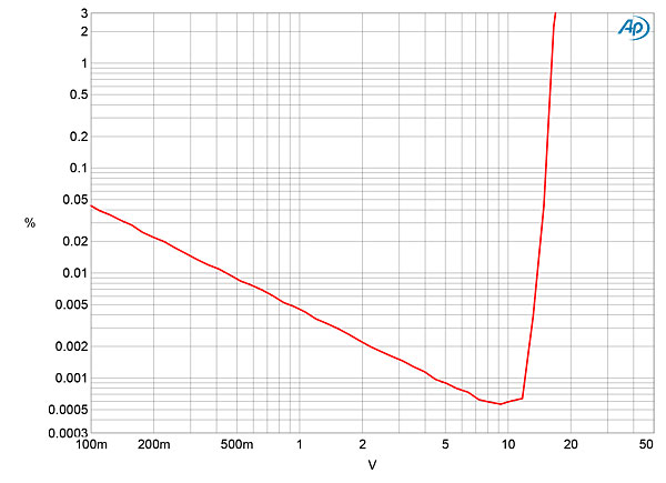

I think that all boils down to power amps input Sensitivity for Full Rated Output ... usually 2Volts.  It is too high.  Line preamps have absolutely no problems in putting out 10 and even 20Volts noise and distortion free.  An example here
https://www.stereophile.com/content/bryston-bp-173-line-preamplifier-measurements
the sweet spot is around 10V and that could be the input standard sensitivity for a power amp.  I have been told that would be better to place more of the gain of the chain in the unit with the lowest distortion and noise (so the preamp).

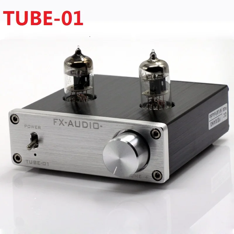

Hi ! thanks to all for the very valuable advice and i think i may have found a solution.  I have at hand a tube buffer with volume pot.  This one
https://www.amazon.it/FX-Audio-TUBE-01-Buffer-Amplifier/dp/B06XCT2ZGS
I could place it after the preamp and before the power amp and so reducing the voltage to the power amp.  Being a buffer it should not have particular issues to drive the power amp.  In this way i could use more of the gain of the preamps and have a better control of the volume.
Moreover the tubes can add some warm to the sound that is often a good thing with digital sources.
