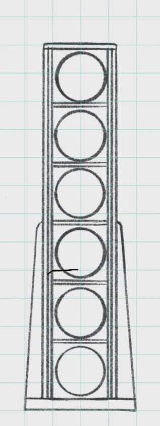

But imagine a pair of monster OB subs towers on either side of the NX-Tremes or LineForce.. you'd probably need a stand for each plate amp, just to keep the runs as short as possible.  :o

Since I enjoy doodling random ideas for speakers I thought it’d be fun to design a quick 6-sub tower. Of course it’ll probably end up running 6.5’-7’ tall.. but there’s not much fun in being realistic. :P
