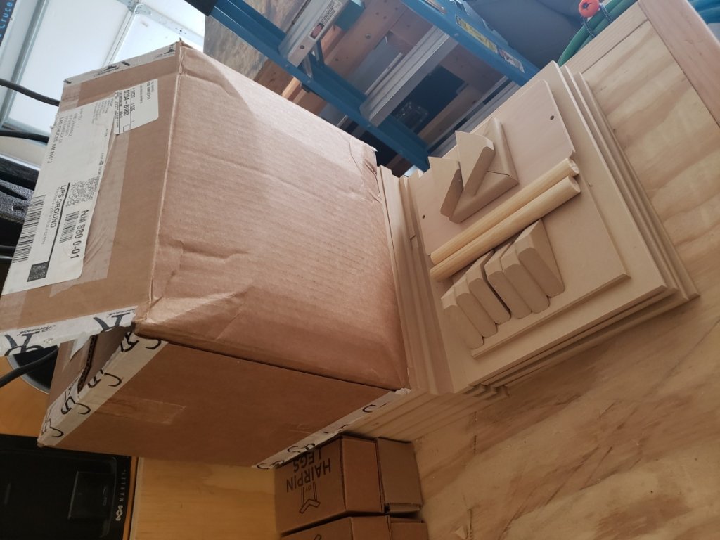

« Reply #12 on: 25 Jul 2020, 02:48 am »
Received the XC-S flat pack from Killian, came well packaged and dry fitment was near perfect. I have to go back and make sure I dry fit it correctly as I'm assuming the x-over goes in the center of the enclosure on the floor in the open space of the center braces. Just need to figure out where the (4ea) 45 degree braces go (I'll refer to Danny's build notes) and make some additional filler pieces for the 2 outside routed through channels....

« Reply #13 on: 25 Jul 2020, 03:18 am »
Nice! Killian does some good work, Im really happy with the X-LS cabinets I got from him, & if I had the room for a center channel, I'd definitely build one. Even if i used it as a sound bar for my TV, its would be worlds better than the built in speakers...  :lol:
But yes, the x-over is meant to fit between the two center braces.
To reduce interference with the spundwaves of either internal woofer.
