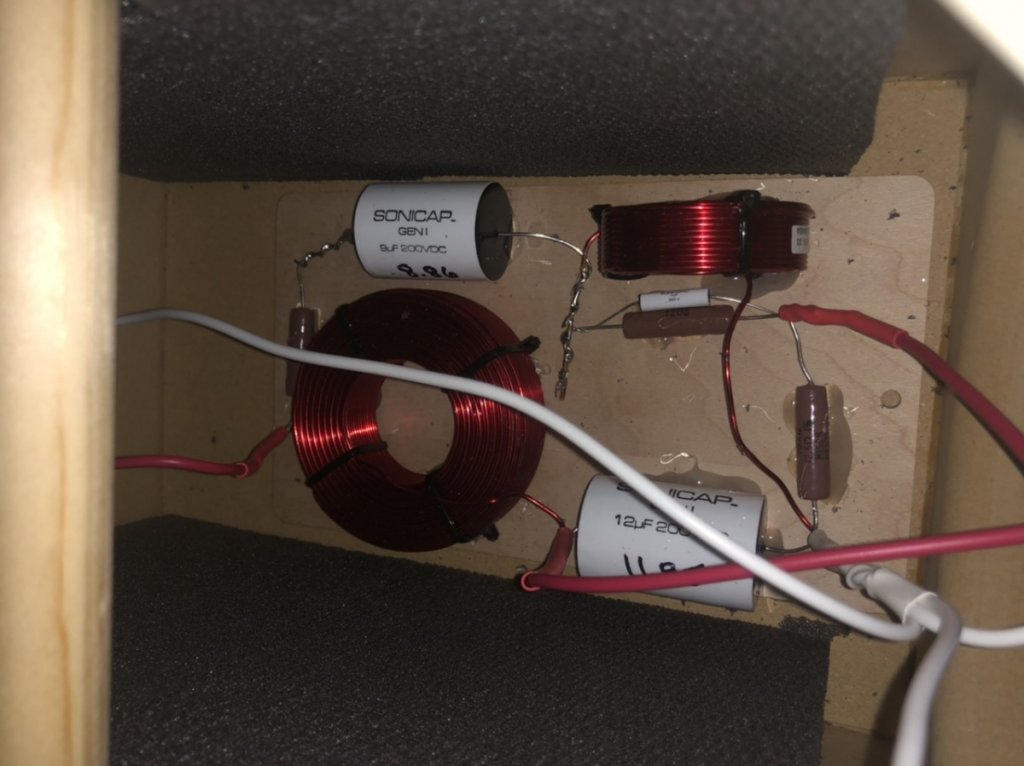

Hello everyone, first post here on audio circle.
I recently finished building a set of X-LS Encores and have put about 20 hours of listening into them yet I am disappointed in the bass/mid bass... it just seems lacking and almost non existent.  The lack of low end quickly causes listening fatigue.  Adding a sub to the pair helps yet the mid bass is still lacking... male vocals feel distant.  Unfortunately, I do not have a calibrated mic to verify these observations.
I am most certain this is not how the Encores are supposed to sound and I 100% believe I am doing something wrong.  I was a little confused with the wiring of the crossovers yet I followed other people’s wiring from a few photos of complete X-LS crossovers.  Can someone take a look at my crossover and see if I‘ve messed something up?
Other variables I haven’t ruled out yet:
-Source: currently just using an iPhone With the lighting to headphone adapter.
-Amp:  I also built an amp following Toid123’s ICE Power class D build to go along with the Encores.  I have not tested this amp on any of my other speakers yet.
-Craig

« Reply #1 on: 23 Jun 2020, 03:09 pm »
The last time I did an X-LS crossover I assembled it this way.  And to make it more confusing in this pic, it appears I used red for negative and white for positive.

« Reply #4 on: 23 Jun 2020, 07:59 pm »
Did you make sure the inductor leads were completely clean down to bare metal before soldering?  Looks like your circuit is good.

« Reply #5 on: 23 Jun 2020, 08:34 pm »
Positive and negative switched on one speaker/woofer?

Re: X-LS Encore - no bass
« Reply #7 on: 23 Jun 2020, 10:14 pm »
Thank you, everyone, for the suggestions.  I'll have to try to eliminate some variables later tonight.
I did make sure all inductors were scrapped down to the bare copper and got good solder joint to them.
« Reply #8 on: 23 Jun 2020, 11:24 pm »
Check each speaker separately with a pink noise source driving the amp and see if there is bass.  If you them check both and the bass goes down, then one of the speakers is reversed polarity in wiring.   Just be careful with volume level in testing.
« Reply #9 on: 24 Jun 2020, 12:29 am »
You can check woofer polarity with a small battery and watching which way the cone moves.
All the drivers in a speaker can be checked to see if they are in the proper phase using a smart phone and an Android or iPhone app
https://www.audiocircle.com/index.php?topic=166023.msg1763920#msg1763920
« Reply #10 on: 25 Jun 2020, 02:10 am »
Sounds like you have a polarity flip on a woofer or with your speaker cables.
