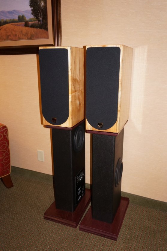

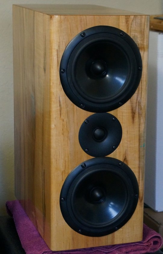

The X-CS Encore is an MTM model that can be used as main speakers with either midbass modules or a sub. The X-CS Encore can also be built into a ported floor standing cabinet that is -3dB at 40Hz and can play lower with room gain. When built into the floor standing cabinet, the X-CS Encore becomes the X-MTM Encore.
X-CS Encores as mains with midbass modules built into the speaker stands:
X-MTM Encore:
