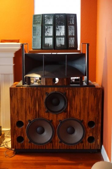

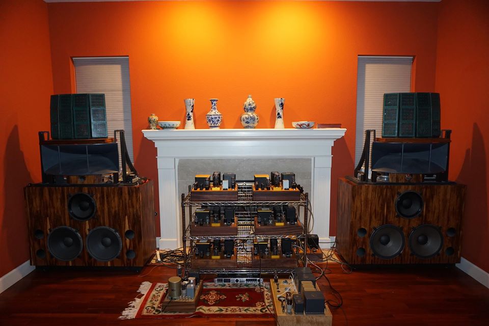

Unison845
My experiment with all out effort putting together an active  Quad-amp Horn system.
opnly bafld
95dB and 4 watts would work for me since I don't "rock out" even with rock.

Pretty impressive system opnluy bfld . Given 4 watts being  sufficient a good 300B SET with their magnificent mid range sound sound fabulous.
