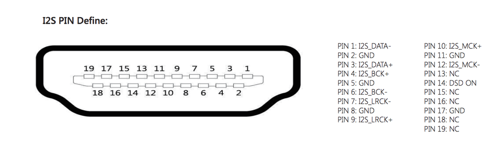

NuPrime I2S format:
For compatibility with other brand's I2S, every pin must match. We can't and don't have the competitor's products to do testing.
Pin14 is used to indicate if the format is DSD, and it is used by Nuprime DAC devices. Other manufacturers might not have this pin.
Ask your other manufacturers to provide their I2S format so you can compare pin by pin.

The Nuprime players work with all the other PSA DACs so there is no reason for them to have changed the pinout on just this one unit.  Their pinouts are noted on their website or he can just call them. It says that it is the same. Mine has worked fine for two years. I would suggest trying another cable even a cheap one will do.
rustydoglim
Re: back in the game again, time to learn
« Reply #9 on: 7 Jun 2020, 04:49 am »
Thanks. We found out from some customers and in our own test that a decent (doesn't have to be expensive, and we provide a free cable with our CD player) HDMI makes a different.
