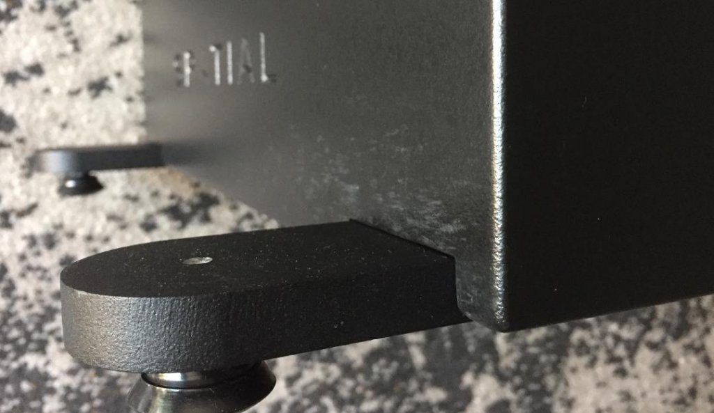

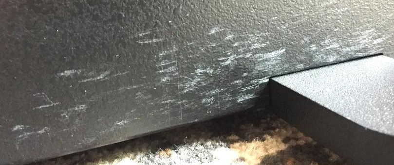

I'm reaching out to the collective brain trust....
I received a second hand pair of M3 Triode Masters in black, and unfortunately they acquired some paint/finish damage while shipping.  I believe what happened was that the protective clear bag was wrapped around the bottom edge of the speaker, creating some wrinkles in the plastic, that acted like pressure points when the speaker was placed inside the custom shaped shipping foam.  As the speaker bounced along in its travels, the plastic wore into the finish.
I have tried:
- Water
- Rubbing Alcohol
- Toothpaste
Nothing helps.  The marks do "disappear" when wet, but when dry, they come right back.  I believe this means that the clear coat has been scuffed up.
Any tips or tricks would be appreciated!

I think it may need a combination of that and possibly some wet sanding to remove the clumped up “white” parts of damage.   The issue with all of this is that the finish is textured.  I just want to make sure the repair isn’t more noticiable than the damage.

In the mean time, I tried a different toothpaste (old fashioned style) and it helped.  It removed the coarsest damage... the "white".
What is left is a difference in sheen between the damaged and non-damaged areas, and a minty fresh aroma in the air.
The easiest way to fix it would be to put a new coating on that evens out the sheen... so that could be a light spray coating, or a wipe on solution.
For now, I am holding off doing anything else until I get some clearer advice.

Since the marks disappear when wet it tells me there is just a little abrasion / compression marks in the clear coat of the speaker.
I don't think rubbing them out will do other than give you a worked / shiny spot in the rubbed area.
What I would do (40 years in wood repair, finishing and refinishing business) is get a can of clear wood lacquer at your local hardware store in the appropriate sheen which is most likely satin or semi-gloss. Probably satin.
Then I would very lightly, at a fair distance away (12 to 14") mist a little onto the effected area. VERY LIGHTLY is the key, you're not trying to do a wet coat just add a little over the top. Kind of like a very light fogging. Mask off anything like the feet you don't want to spray. I would do a very light, small sample on the bottom, back of the speaker first to see what effect it has and to check sheen.
Another simpler fix is to use a very light colored furniture touch up pen. I used to use art felt pens I got at Michaels because they have the best tips and color selection. The key is to pick a very light color that will not add color but just make the white go away. Again go slow and lightly. Sounds stupid but it works.
The key to touch up is to go slow, and do just enough and no more. The more you work it the more it will stand out. You're lucky that at its way down at the bottom so not easily seen.
Last thing you might try first is if you have any Old English furniture polish (the dark scratch cover stuff) put a tiny bit on a Q-tip and dab a tiny spot and carefully wipe off any excess. That might leave enough color to minimize the spots. Problem with that is the spots might come back over time as the polish dries.
YMMV of course and I take no responsibility for the outcome as I'm not preforming the work. Just letting you know how I would do it.

theater_lover
  • Posts: 149
Re: Paint Repair?
« Reply #8 on: 27 May 2020, 07:11 pm »

The likely cause is the plastic over-bag directly rubbing on the paint surface underneath the rigid foam end cap in shipping. When they leave our factory, the speaker is first covered in a plastic stretch film, so that the over-bag is not directly contacting the paint. We have had excellent shipping results using this method. When buying a used product, all bets are off.
The paint is a medical grade, 2-part Polyurethane paint with a textured top coat and no separate clear coat over it. It seems like Woodsage is correct in his recommendations, but he would not have known that there is no clear coat. The problem with trying to rub it out is that not only will it probably not work, but will likely leave a shiny area that will look even worse. The company that paints the speakers for us said that when they run into this type of abrasion issue, they just re-paint the entire product, as repair is usually not workable.
So the best solution, short of re-painting the speaker, is to try the furniture markers to cover the white abrasion marks.
Clayton
