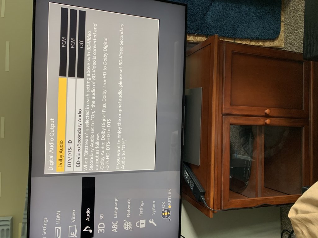

I just purchased a Panasonic UB-9000 4K player brand new. I hooked it up to my TV with HDMI from the video output. Then I hooked up the coax to my AVA DAC. Music CD's play fine, but when I put in a Blu-ray Disc, the picture works but I only get noise. Frank’s DAC can only decode PCM. My Oppo 203 output was set to PCM. The Panasonic does not tell me what it’s output is set to. I have changed every setting that I think it could be, to no avail. I don’t want to send the unit back unless it’s defective. Any help would be greatly appreciated. Thanks in advance!

I think you need to select the audio output for each of the multichannel formats.
Audio  >  Digital Audio Output  >  Dolby Audio  >  PCM
Audio  >  Digital Audio Output  >  DTS/DTS-HD  >  PCM

From the Home menu
Setup  >  Player Settings  >  Audio

Thanks both of you for the help! I don’t know why my picture turned sideways.
