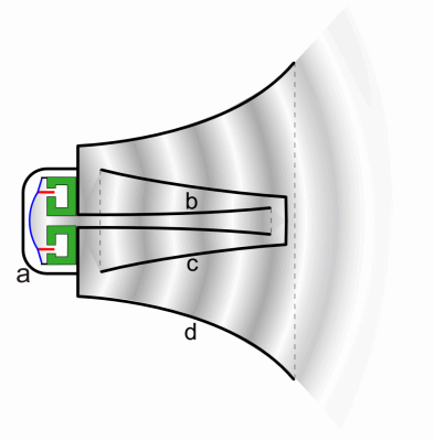

You could get the delay by creating a megaphone like folded horn.

Which leads us to the folded horn.  No.  One, it's now no longer an open baffle design.  And two, the wavefront would still be measured from the front of the baffle no matter how long the signal bounces around inside the cabinet.

Do disagree with Letitrol98 about the distance of the folded (bass) horn.  The relative distance sound travels from each voice coil is what matters in reference to the needed 11 ms delay, so the route through the horn counts.  But we aren't discussing bass versus mid/treble.

Thanks for the reply JLM, but I'll continue to maintain that I'm correct about the folded horn.  But I'm going to start with an aside.  The delay we're talking about is a reflection off of a boundary to the listener's ear compared to the direct sound from the speaker to the ear.  So the delay is not measured back to the speaker, but rather to the listener, and is measured as the delay from direct sound from the speaker reaching the listener.   So back to the folded horn, you could bounce the sound around inside the speaker for two days and the boundary delay would be exactly the same.

Second, I know folded horn designs sound terrible due to how they distort sound.  This might not be an issue however as you don't need to create a horn shape for one, and secondly, this isn't modifying the direct sound waves you are interested in hearing. This is modifying reflected background noise.
Third. The folded horn would create nasty resonance patterns as sound waves reflect back to the driver... You would need to have the reflective surfaces occur at a gradient of distances to smooth out the harmonic resonances.

I may be misinterpreting your diagram.  As drawn it appears there's an enclosure on the front of the driver (a).  So there's no enclosure at the front of the driver?   In that case dump the horn and move the speaker further into the room.

The last image is just a graphic I found showing how a megaphone works.  The thought was to reflect sound before emitting it in order to increase the phase delay behind the speaker.
