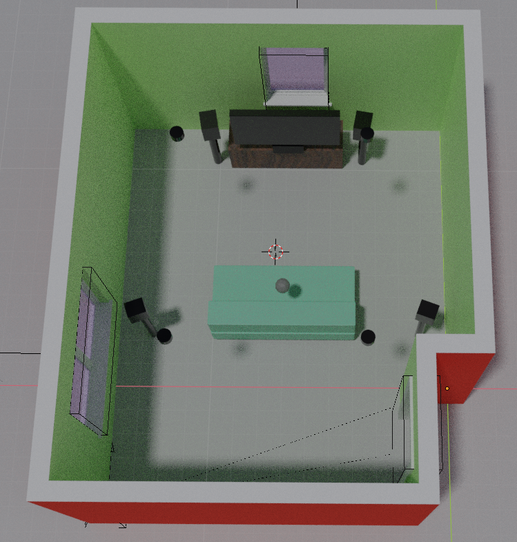

Thanks everyone for your observations and experiences.  It is all very helpful.  Since I am in a dedicated room, I could go either way, but I have the space to do OB.  Getting them out 7' from the wall would be a non-starter I think, just based off of the geometry of the back of my room.  I could make it to about 4' fairly easily, though, without impeding on the video side of the room's function.
Attached below is a plan I did for the room, and the current implementation is pretty similar (photo attached).  The front speakers are about 3 feet from the front wall already, and could probably come out another foot.  I'm not sure if the narrower back part of the room will be a problem.  Also, the walls and ceiling are lath and plaster and I'm not sure if that effects room resonance or reflectivity.  Any thoughts are appreciated.

I'd move the listening position back a couple of feet, push the TV and stand back to the wall, and bring the speakers out into the room 4 feet.

Yes, agreed, move seat back, screen back, speakers forward, and treat the wall behind the speakers and have at it with your OB fun.  Warning.... you will be sorely tempted to mov the speakers farther into the room. You have been warned, ha.
