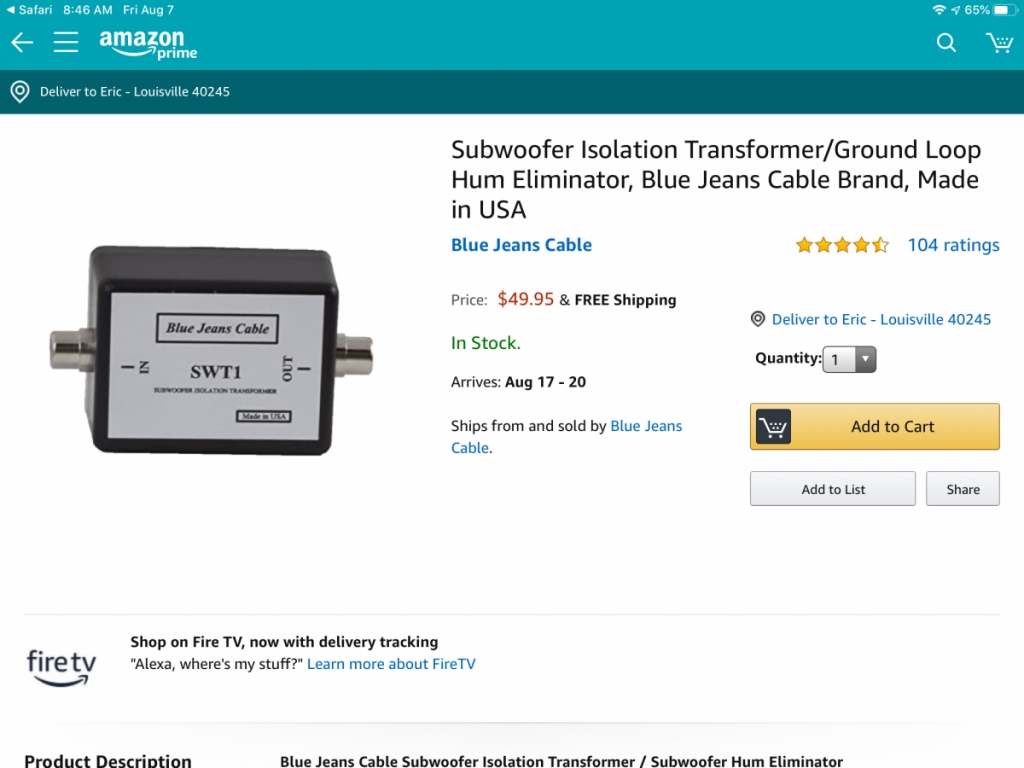

I just did a quick read on Blue Jeans Cable's website about their isolation transformer to eliminate hum in a system while I was researching speaker cables.  I would check it out and they are also a small US based company if you have any questions.
What BJC page was that?

Yes, I later realized the the BJC transformer was a signal transformer. Not an AC power isolation or balanced power transformer.
