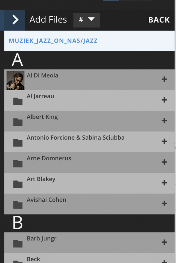

It does show on my Jazz folder which only has 92 I now notice ;)

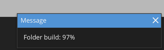

but wait: I now see this popup:
that's new to me..

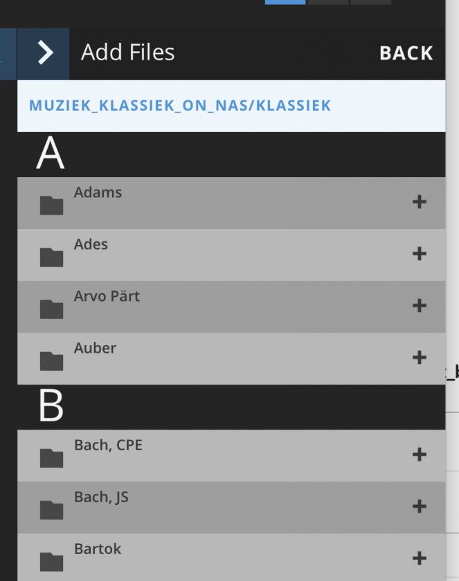

yes that is my top folder for classical music, with 110 subfolders, 1 for each composer. I checked a few other top folders, and they do show the dropdown alphabet.
Haven closed it, as I was afraid to interrupt a proces that had been going on for hours ;)
In the end, I power down, and everything needs to startup from scratch on next power I guess? Or is this somehow cached?

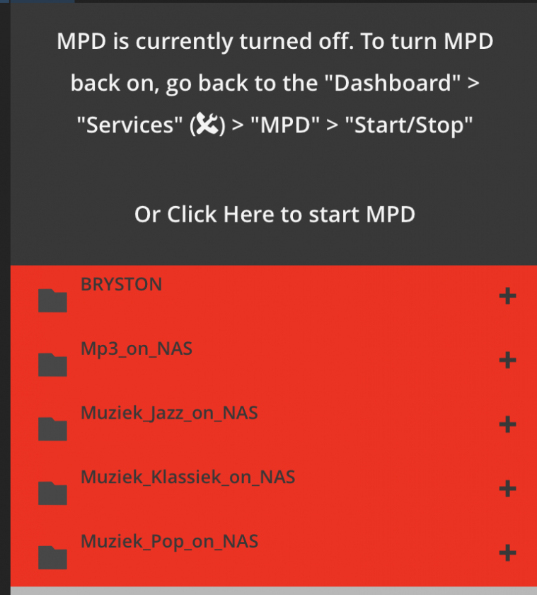

It always starts like this:
and after a while, probably around a minute, maybe 2 the folder list appears:
without dropdown box
while eg my Jazz folder has it immediately
