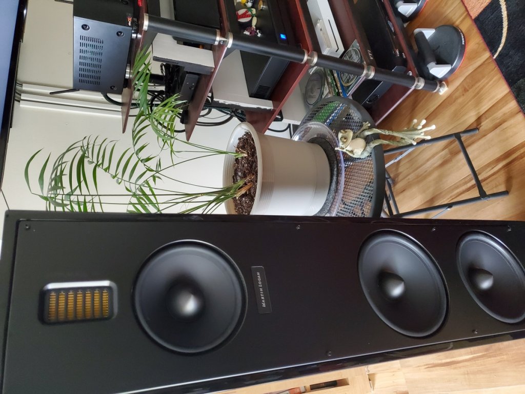

Martin Logan Motion 60XT
« on: 15 Apr 2020, 03:09 pm »
Would you, should you, have you upgraded these? Advise please, thank you.

Hi, I suppose I should be more specific, I love the YouTube videos Danny has been doing  and am very interested in the "kits" he`s mentioned on the speaker he happens to be working on in the video at the time. Was looking for any suggestions/experiences if anyone out there has tried it with a pair of these. I am happy with the sound but you know... is there more to be had? Thanks in advance for any info.

I own a pair of Martin Logan Motion 60xti and might be looking to make them better.  They are pretty damn good now though. And I am posting to get my 3 posts in so I can do a search.
